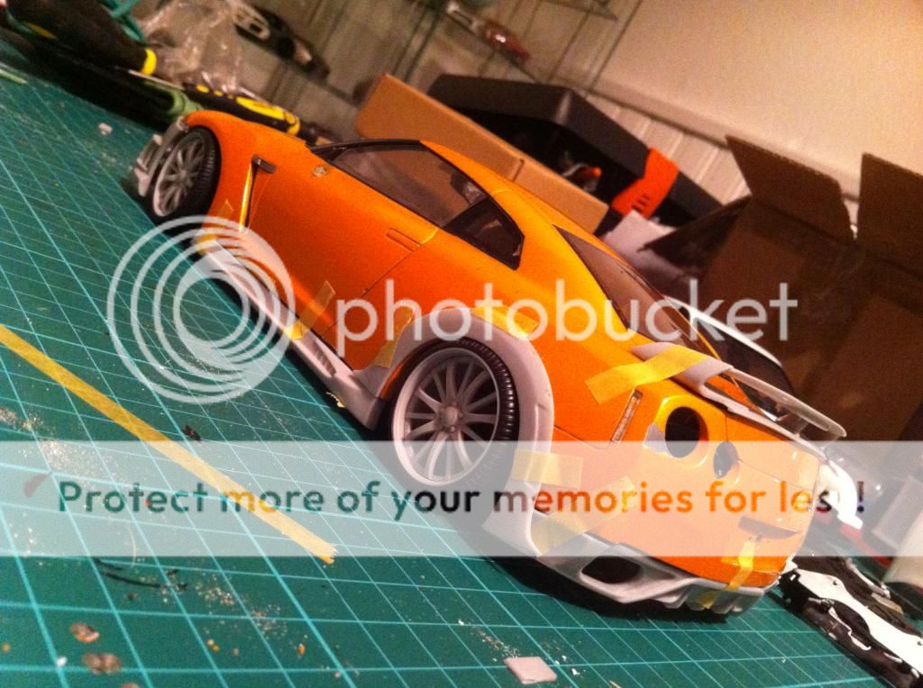

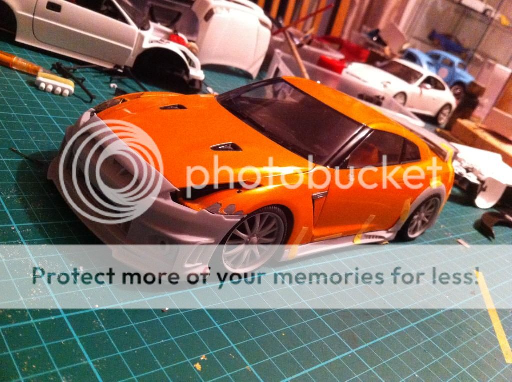

I wouldn't worry about cutting up the r35, it's a very strong shell. I've cut the front bumper and both side skirts of mine and it is just as strong as before. Plus, you could easily avoid having to a do a full repaint if you are careful when cutting- I was going to fit this kit to my black r35 and color match the parts but my orange one was damaged anyway
