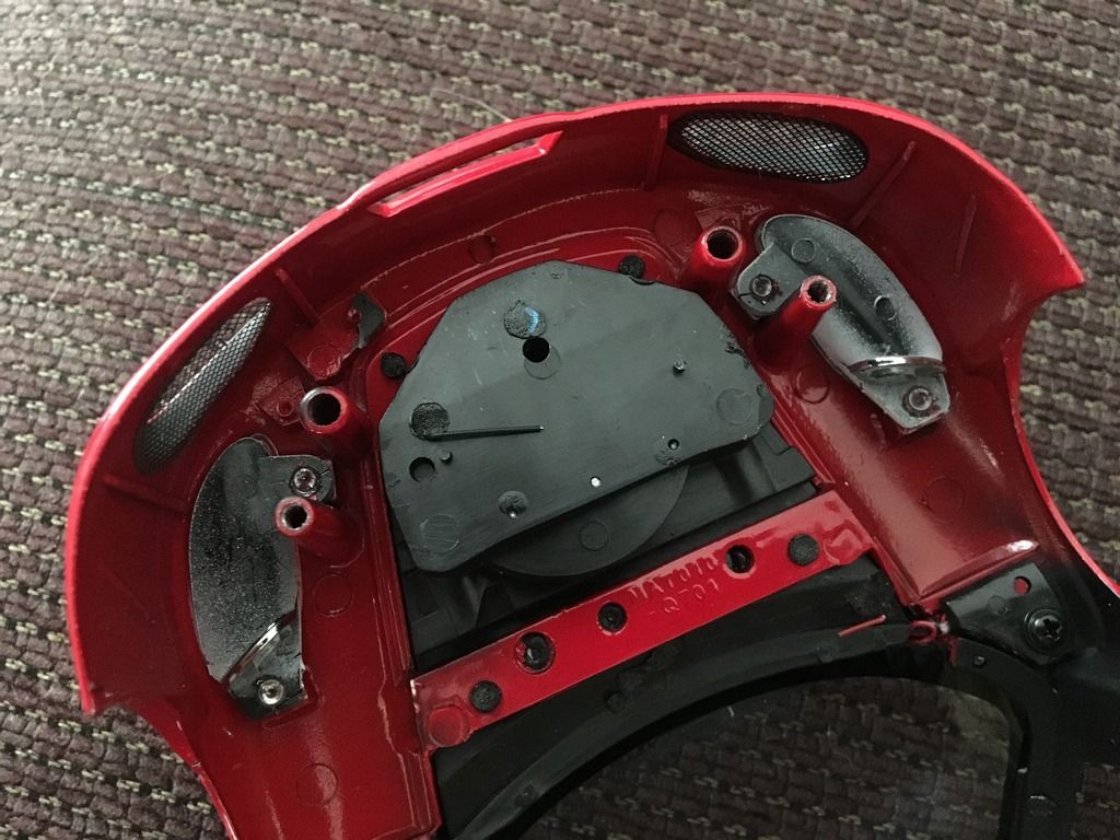

Sorry again for the lateness in the response but here is a picture of the model (underside view). It seems to be glued but I'm not familiar with these models that much.
As for the mirrors, I was thinking about that as a secondary option. I have primed and painted some rims before, it shouldn't be that much harder, haha. Thanks ibj40.

Posted 25 April 2017 - 06:24 PM
Okay, so the headlights are actually a reverse of what I was referring to. They are held in by a "mushroom" cap of diecast material. Your best bet is to use a Dremel with about an 1/18 inch drill bit, and with very little pressure, put the point of the drill bit in the dimple and drill off the mushroom. If you press too hard, you run the risk of transmitting too much heat into the metal and melting or distorting the plastic. The drill bit should knock the mushroom cap off, and also heat the plastic enough to loosen it from around the diecast stalk.
For reassembly, just put put a dab of glue on the stalk to grab the plastic.
Good Luck!
