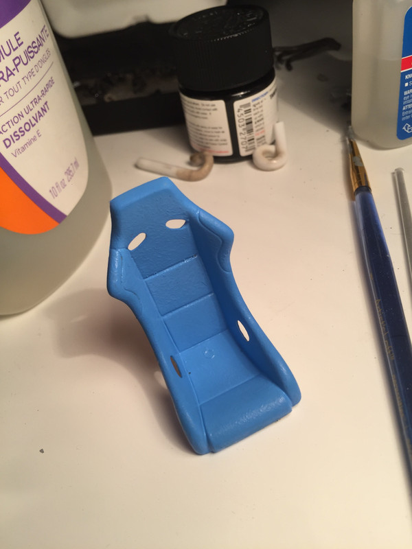

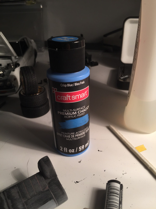

I started using these matte chalky paints available at my local art store for like $2
bottle looks like this
when first applied it looks like this
after drying, and this is just one coat, it looks like this, nice and dry and feels like felt
I also used it in black
I assume you can keep adding coats to make it more and more like the felt material without the hassle of resorting to flocking messes
Edited by StratosWRC, 13 December 2019 - 08:00 AM.
