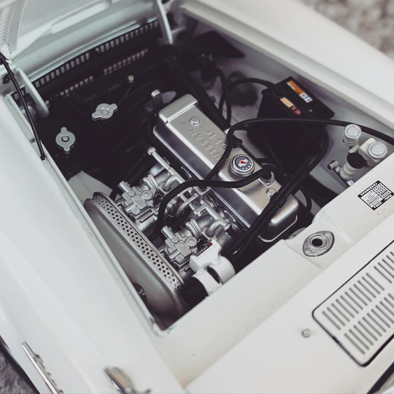

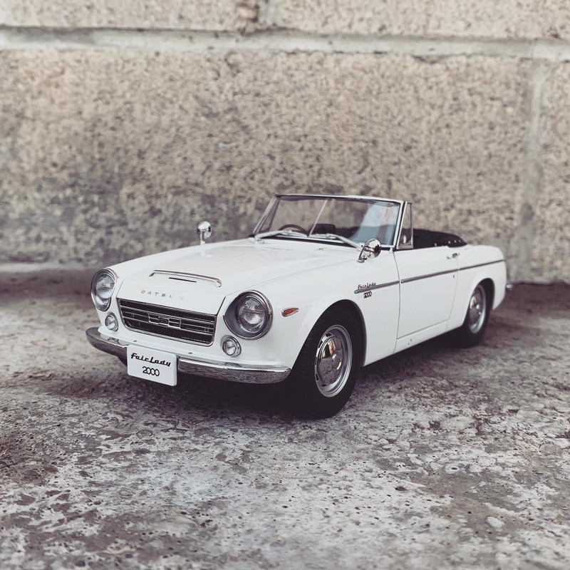

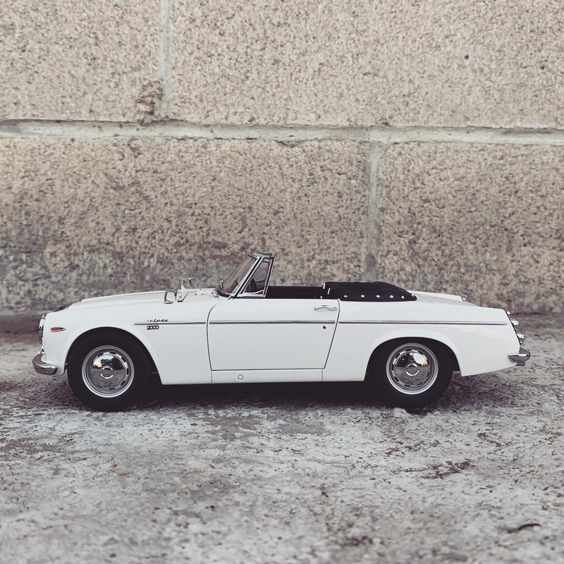

I love the Autoart Fairlady, really awesome in every way and hard to come by these days. Found one locally for a decent price as I've been wanting to do this engine swap for a while. Here is the model prior to violation

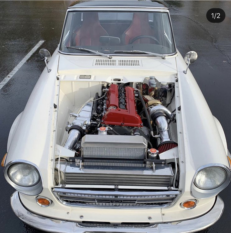

And here's the 1:1 inspiration for this build. It's got almost 500 whp (if not more) which must be insane in such a small car.

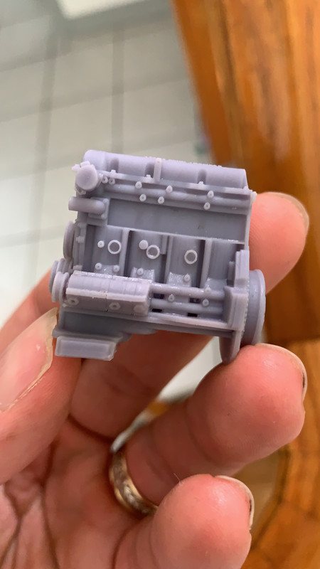

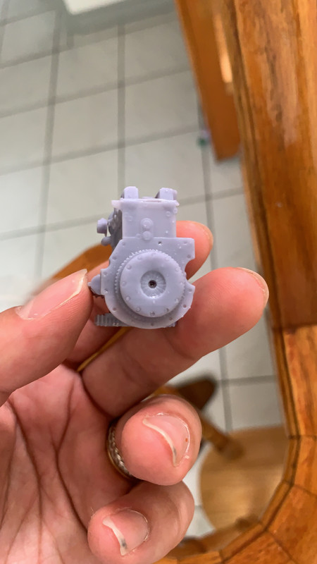

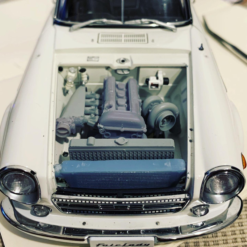

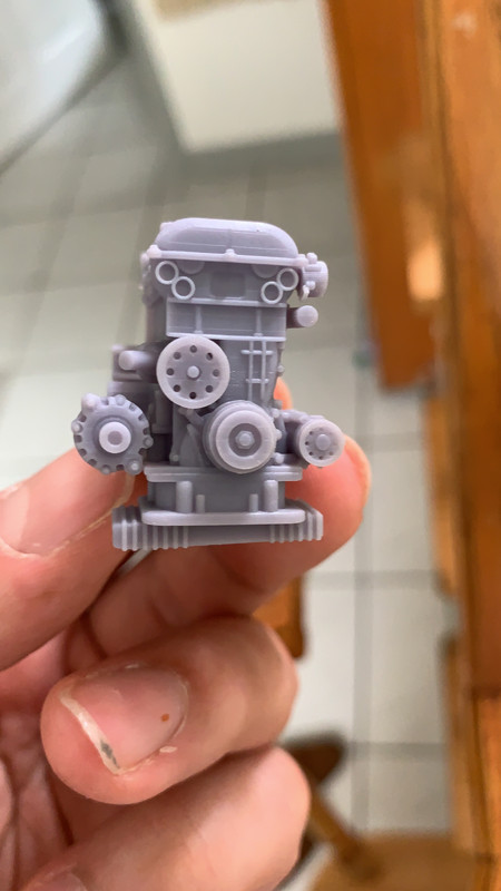

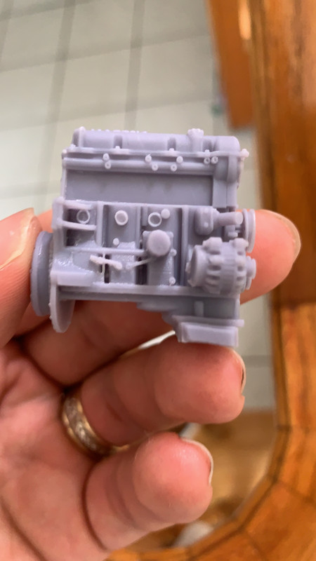

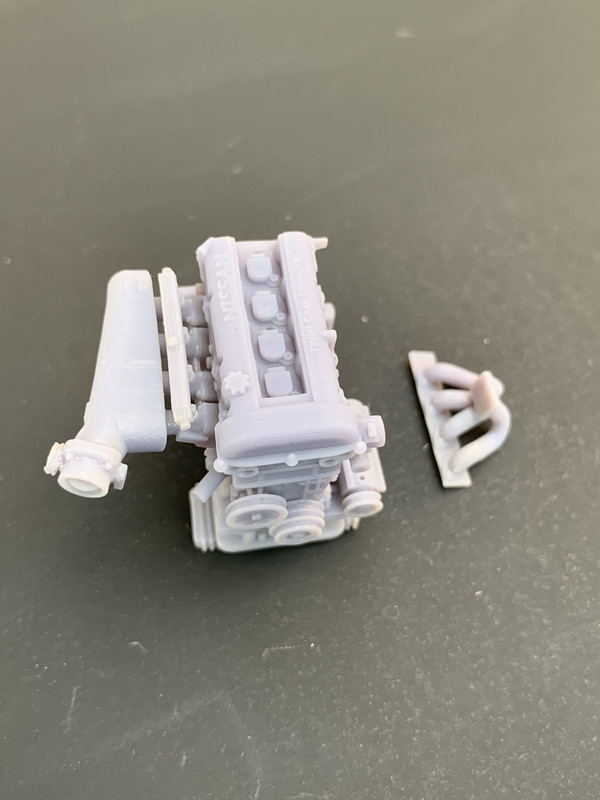

Engine 3D printed from 3broductions superscale on Instagram. It's okay... I say if you're looking to get one, wait until the TKDiecast version comes out. It'll be much better

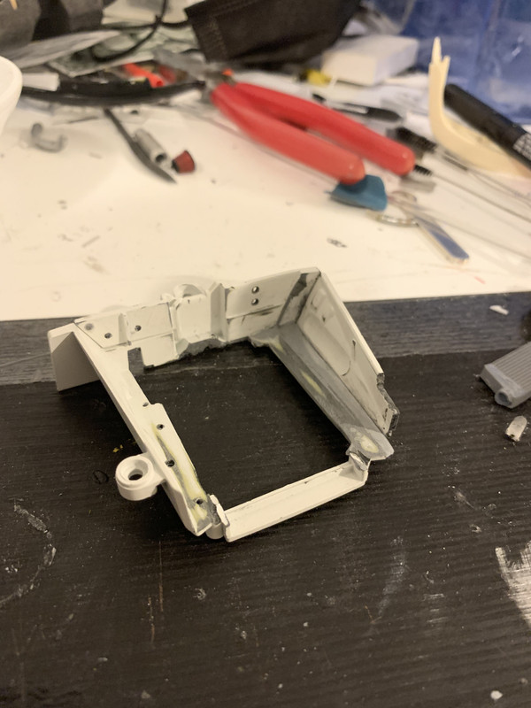

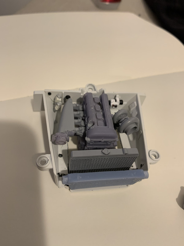

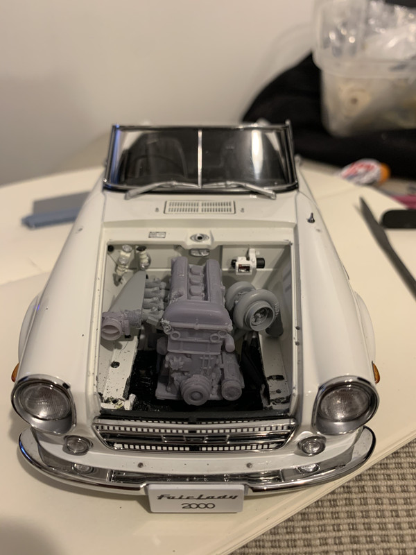

Quick dry fit to assess how cramped things are

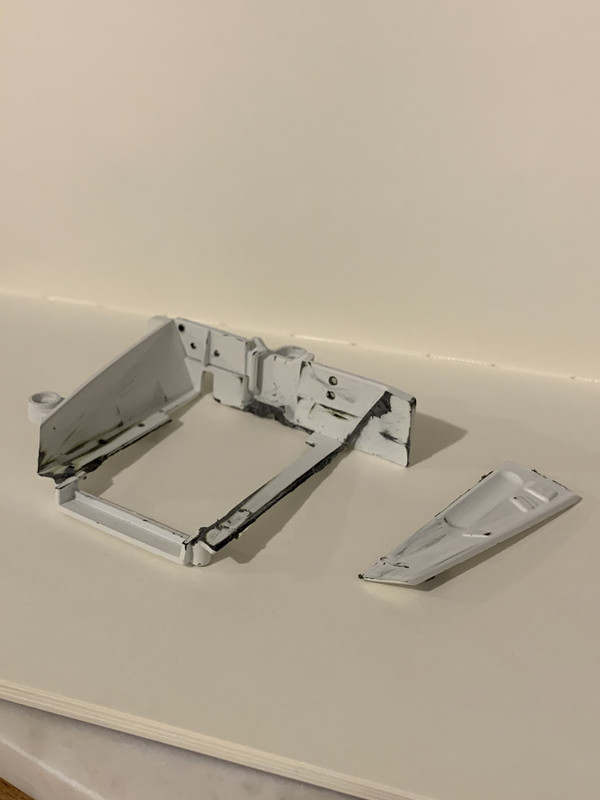

Pretty cramped, so I decided to expand the bay a bit

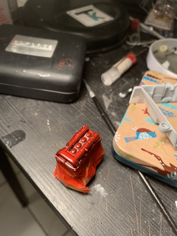

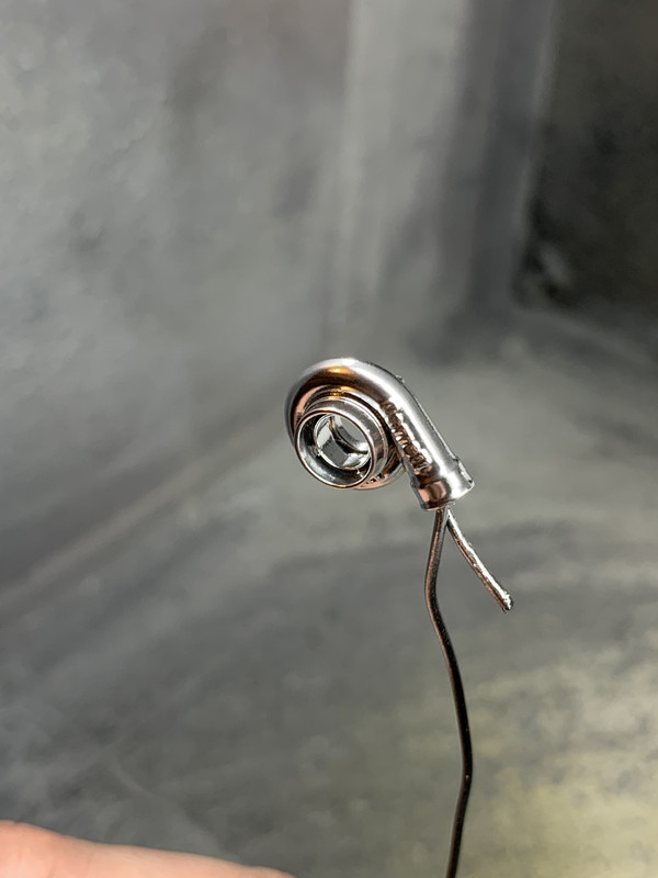

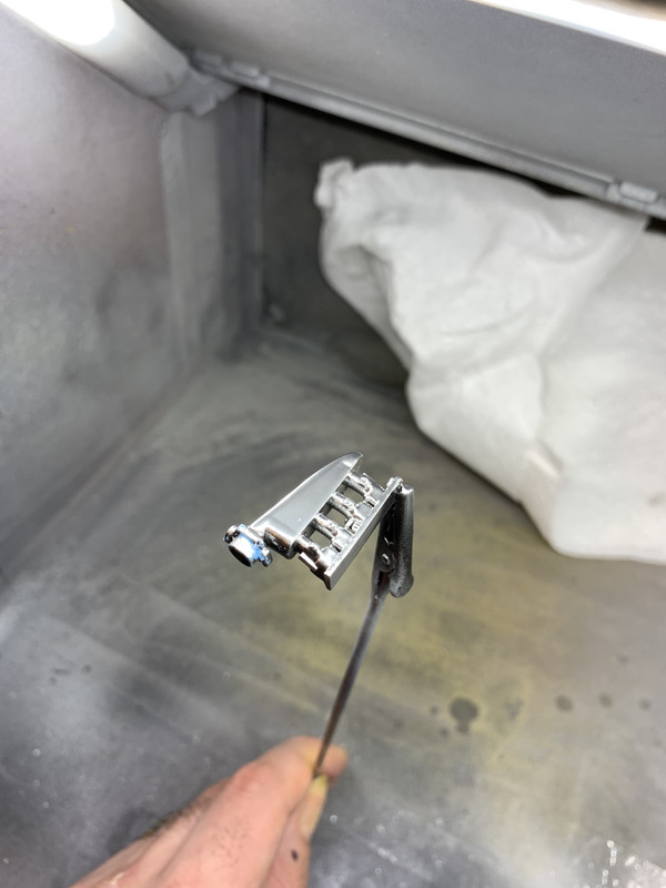

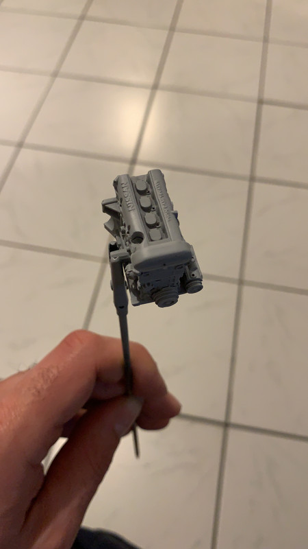

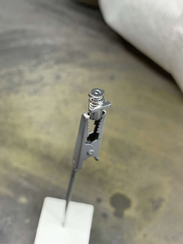

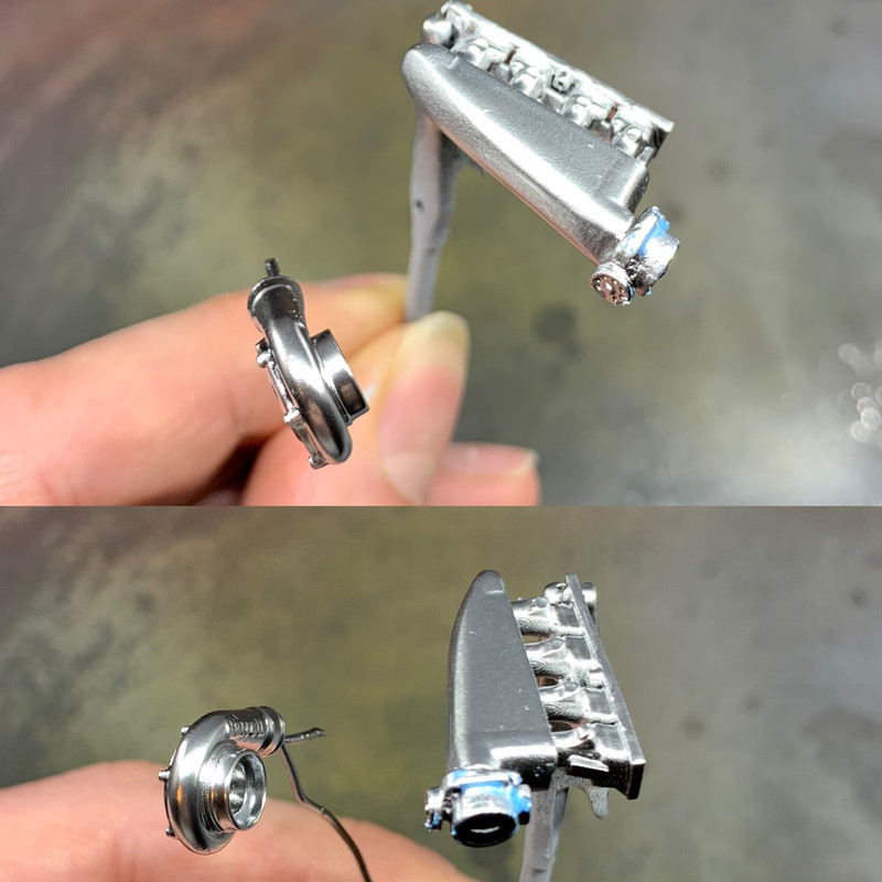

Having done that I started painting engine bits with Molotow Chrome over gloss black
I sanded the engine down (super important with 3D printed parts as the surface looks like a turd) and drilled out a hole on the valve cover for a different oil cap from TK Diecast that I'll be using
painted

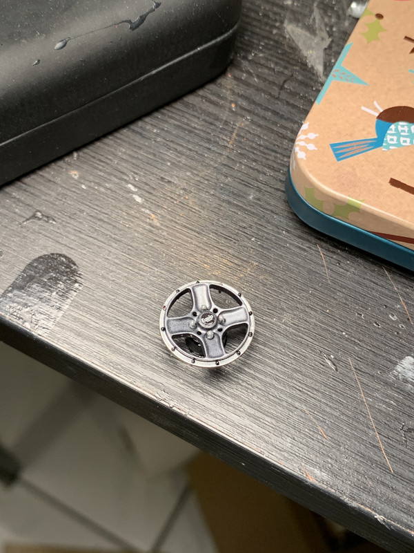

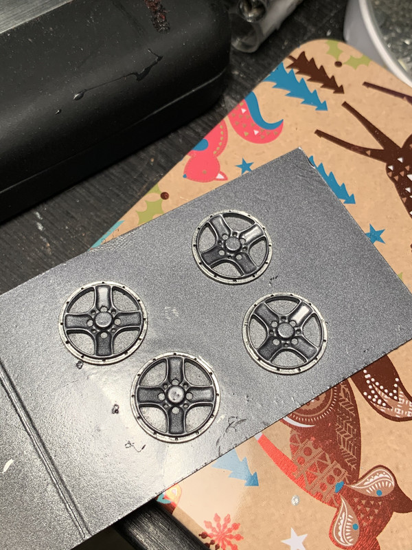

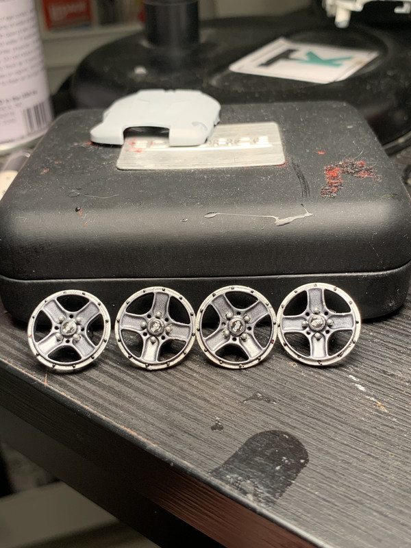

For the wheels I decided to go with Work Equip 40 from TK, painted in semi gloss gun metal over gloss black and molotow around the edge

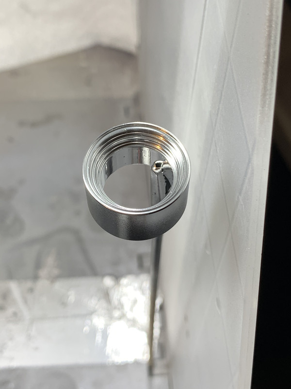

Barrels - same story, primer > gloss black > molotow chrome

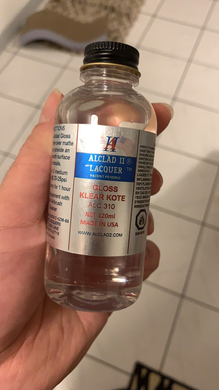

Hoping to coat the Molotow with this, which apparently preserves the shine

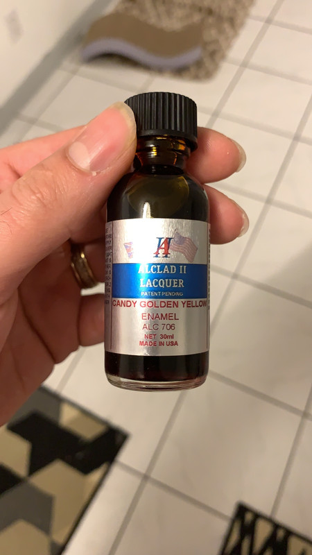

Then some Alclad Candy Yellow to make the turbo hot side look like it's been treated with gold heat coating like in the 1:1

Also, here is what happened when I sprayed a chrome part with 2K clear. It definitely dulled the finish. Just Molotow left, 2K clear right

I like the idea a lot!!! The engine will look very nice in there. Unfortunately chrome spray hates clear coats... Keep going, don't let this stop you. :eusa_clap:

Oh I already resprayed the intake manifold and it looks even better now. Just wanted to show what the clear coat did. According to the forums the Alclad Klear Kote Gloss (horrible name lol) doesn't dull the shine, so we'll see...

Engine painted

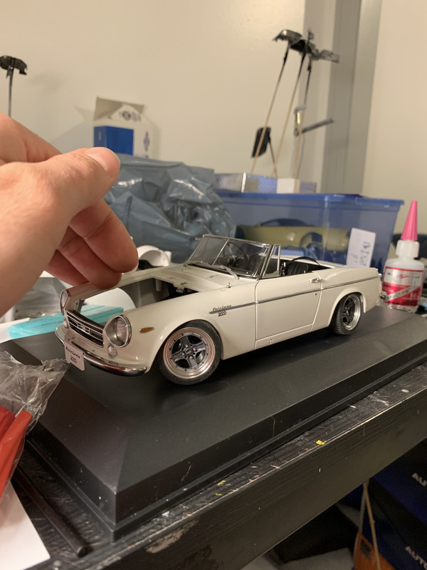

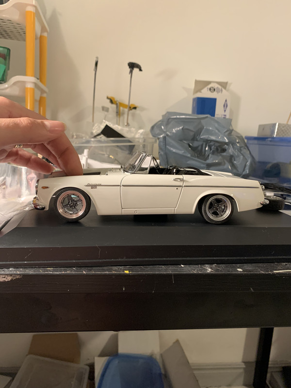

Now off to the wheels. I attached them - although the stance took some time. The rear wheels need to be tucked and the fronts need to have a healthy gap, otherwise the car looks like the front suspension collapsed. Haven't attached the calipers fully yet so disregard those
And now with the hardtop, which I vastly prefer I have to say
Satisfied with that, so now it's on to the final step - the exhaust.
