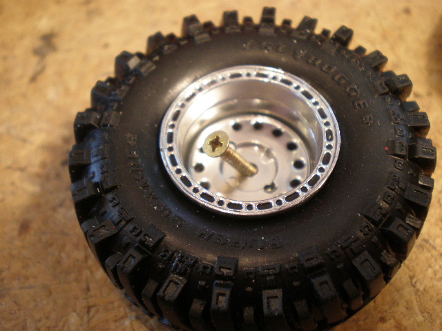

Then you drill a hole for a screw to go into. You need a screw long enough to go through the wheel hole into the axle and thin enough also to go through the hole. I am using screws that are a 1\2 inch long by 2mm wide. I drilled a hole about 1-1.5mm wide so the screw has some grip. You  also should aim to drill in the centre of the disk.
I used a hand drill:
Hole in front axle. Be careful not to drill too far!:
Out the screw through the hole in the wheel:
Back of wheel for reference:
I have some brake discs from another set of custom wheels and these fit nicely into the back of the SoReal wheels. I am using them to help fill in some of the space at the back of the wheel, but they are not required.
Now screw the wheel onto the axle:
DO that another three times and you get something like this:
