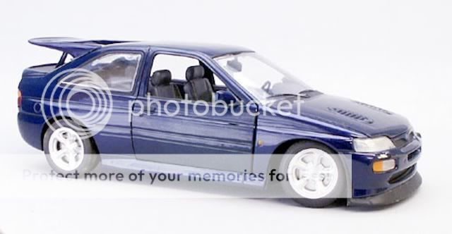

As base, I am using Ford Escort Cosworth road car made by UT models in 1/18 scale. Many of you may know that UT made nice models but not much detailed.
therefore, I had to make a lot of modifications on the chasis and floorpan. also, for the interior I have to built from scratch since the model was a road car. It's a bit challenging because I have to scratch built many parts and try to fit them into the car.
*photo taken from internet, credits to unknown owner. this is the original UT models 1/18 scale model.

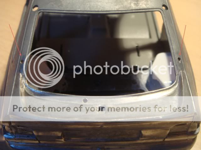

did drill the boot for the pins.
The air ventiles on the trunk were sealed, so I cut them for a better look. also did drill wholes for the hood pin.

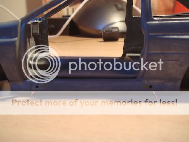

I have drilled the side skirts for the jack.

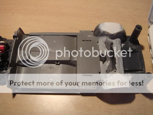

the original floorpan of the UT models is not so detailed. one of the most important missing was the top of the rear wheels were open. so I decided to cover with a stryene
especially the drive train was not so detailed. so I decided to merge the Minichamps Sierra Cosworth floor pan with the UT one in order to give more details, differential, gear box etc.
this is the latest look after merging two floorpans. still lot of detail to fix and finally will be painted into white.
once again I used Sierra Cosworth parts to prepare the inside floorpan. the front floorpan is from Sierra. now need to prepare the back side which probably has to be custom made by stryene sheets.
these days I am busy and try to continue this project when I could. and another difficulty is to find the correct spare parts and to get them. therefore I believe this project will take long time. but I can say I am enjoying it so much.
above took me 2 months to get it into this situation.

after this, I started to built up the interior floor pan. the front piece is coming from Minichamps Sierra while I dont have any part that can fit to the back side. so I had to scratch built it.
I used stryene sheet to cover and fit the back floor pan.
there are still some small touch ups needed but will work on it at a later stage.

this weekend, I worked to detail the interior as well as the bottom of the car. I have also painted and would like to share the latest situation...
here below is the original UT floor pan...
and this is my conversion fitting the minichamps Sierra coswroth's underneath parts & partly floor pan..
the UT floor pan end had the oil tank. since this is a rally car and the tank is inside the car, so this part had to be modified. so I cut off the oil tank and create the chassis part made by stryene square beams.
these photos are as a trial to see how the cage and the interior looks inside the models
there are still some work have to do inside and under the model. some parts need some small adjustments and maybe another coat of white paint to be applied.
as you guys may follow up above, this is going to be the replica of '94 Ypres rally winner Patrick Snijers car. therefore, I am trying to replicate the car at most possible. unfortunately, I think I will be replacing the the original Star shape wheels with the below ones...
the reason is that I couldnt find the correct matching wheels with 4 holes. the Uli nowak has the compomotive star shape replicas in 5 holes.
my wheels were also 5 holes but made of plastic/resin. therefore it was easier to modify them to 4 holes.
these are the latest updates on the model I have done recently.
