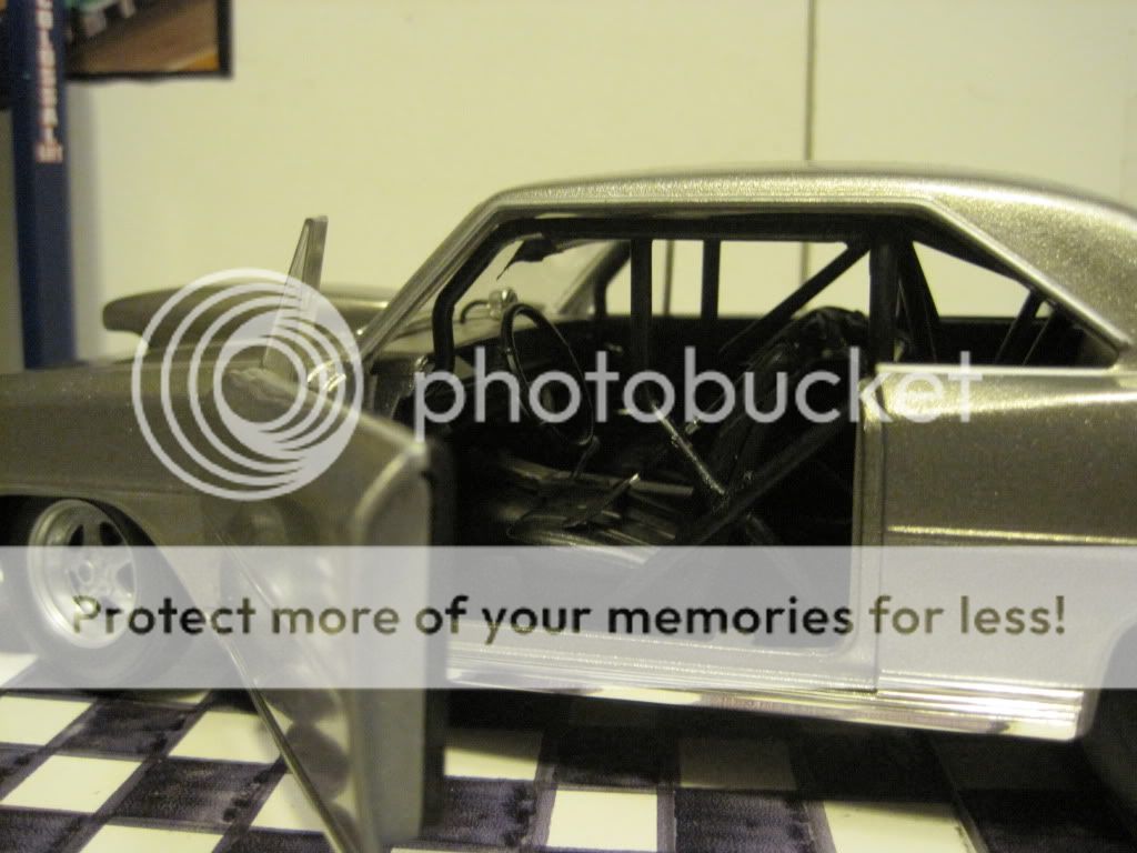

Hi DX,i have one question about the roll cage,how can i make it?what material i need to use?  :lol:
Edited by XDRIFTARTX, 29 January 2013 - 08:14 AM.
#2 OFFLINE   ibj40
ibj40
  • 4991 posts
  • Location:Texas
  • Favorite Brands:.
Posted 29 January 2013 - 08:56 AM
There are frequently kits for sale on eBay, as well as entire interiors from models that have them originally.  I've got several on the shelf, if you would like one.
Can you give me a little more information on what you are going to be putting it into?
Here's a simple roll bar install I did recently that started with one of the kits:

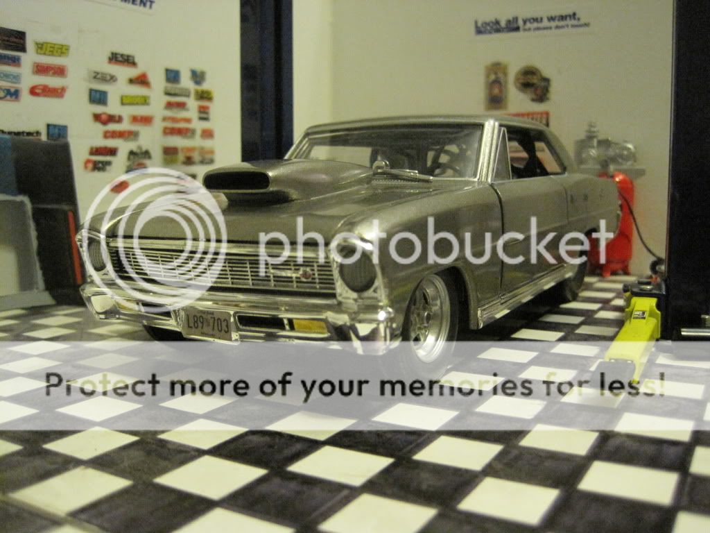

#4 OFFLINE   B1N9S
B1N9S
  • 933 posts
  • Proud Citizen of: uk
Posted 29 January 2013 - 12:56 PM
Get some styrene rods (3-4mm) and some poly cement, also get a small round file.  The styrene is a type of plastic so when you cut the length, cut it slightly long and file the edge into a curve so it sits nicely against the other piece, then cement the two together.
Best to make a mock up using some stiff wire first so you get a rough idea of the size and I find its easier to work moulding it into the shell, rather than trying to fit it on the interior and shell over the top, if you know what I mean ?
Styrene can be bent using heat and will hold solid in position once it cools.

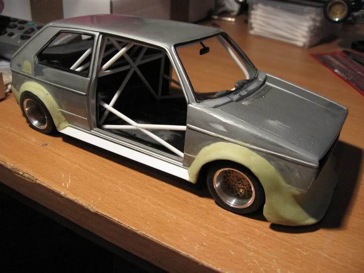

#12 OFFLINE   Dolf Janson
Dolf Janson
  • 7 posts
  • Favorite Brands:Spark, TrueScales, Caroussel
  • Proud Citizen of: nl
Posted 31 January 2013 - 12:52 PM
I like styrene as well i.c.w. polycement and lock files.
Used 4 rods of 2.4mm in my first attempt:

#14 OFFLINE   Dolf Janson
Dolf Janson
  • 7 posts
Posted 01 February 2013 - 12:04 PM
Thanks, will add the pics once i finish it (still not sure about how to paint & apply decals)
I used the file to get a proper radius to make the ends meet in the corners.
A file is what your missus uses to maintain her nails, i have a set used by lock makers and i am sure there is such a set for modelling as well :nice:

#18 OFFLINE   Dolf Janson
Dolf Janson
  • 7 posts
Posted 06 February 2013 - 04:24 PM
View Postibj40, on 01 February 2013 - 02:59 PM, said:
Did you bend or radius any of the bars at the corners, such as the main roll-over hoop, or simply connect them with an angle cut?
Only bends are in the main hoop and a-pillars to follow the shape of the body. Will add more pics once i find them.
Bends made by preheating the styrene over a candle, take it easy cause it'll become like chewing cum and collapse very easily!
For the connections, i cut the bars with a X-acto knife at the right angle (centerline) of the bar i want to connect it to, and then use a round file to give the same radius for a smooth contact for optimum gluewing surface.
Once done it is strong enough the lift the entire car by the cage.

#21 OFFLINE   ibj40
ibj40
  • 4991 posts
  • Location:Texas
  • Favorite Brands:.
Posted 08 February 2013 - 11:00 AM
