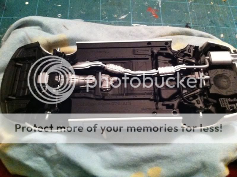

Getting the base off the car;
There are 6 screws, two in the middle clearly visible, two at the rear in the deep holes (one is partially covered by a plastic part but you can still get at the screw) and two at the front under the brake ducts, which need to be removed (unfortunately these will need to be reglued)
Remove these, the floor lifts straight out
Removing the rear wheels;
Take off the exhaust, use a flat head screwdriver to prize it of the mounting pegs (one at the rear under the silencer, one in the centre under the cat)
Turn the base over, there are two small Phillips screws beside the wheel arches, unscrew these
Now the whole rear subframe should lift off, be careful as the anti roll bars etc are fixed to the base with mounting peg, but they'll prize out gently with a screwdriver or blade.

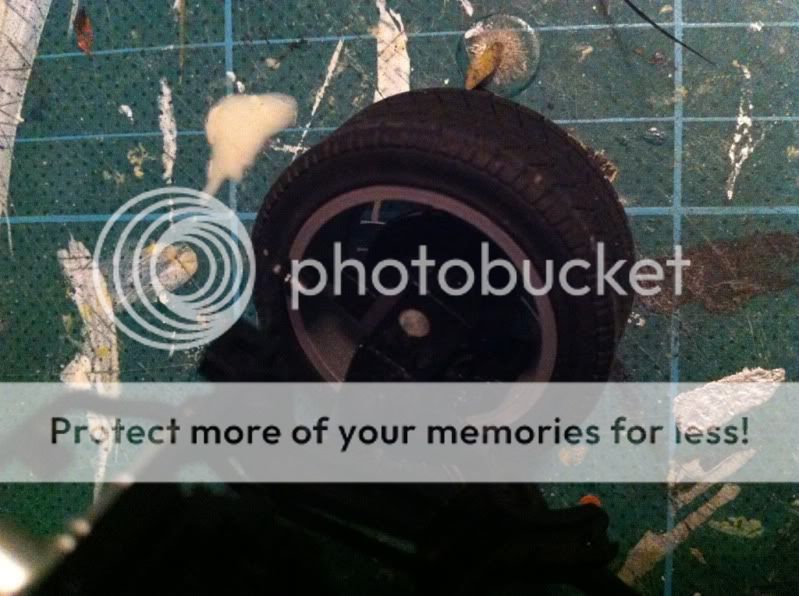

Now take a look at where the wheel is mounted, now is a good time to cut the brake caliper away from the hub to allow more room
At this point you can use either some pliers/tin snips like these or a small flat head screwdriver (I prefer the tin snips)
Squeeze the tool in the small gap between the hub and the back of the brake disc, gently squeeze / twist if using a screwdriver till the brakes come away
Once you can see the mounting pin, grip it with some pliers an gently pull/twist the wheel, it will pop off

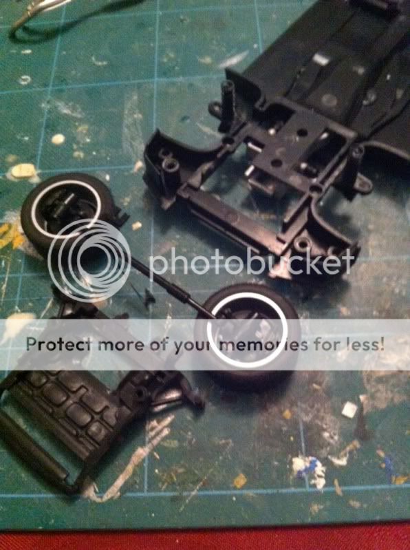

Removing the front wheels;
Again, there are two Phillips screws at the front of the floor as shown
Undoing them will drop the front steering assembly from the car into these parts
Using the same method as the rear, gently squeeze some tin snips between the hub and the brake disc - take extra caution as the hubs are plastic and very fragile, it's a good idea NOT to hold onto the steering bar with your spare hand
Now the wheels are off, reassemble the steering - avoid glue otherwise you risk gluing the steering in one position
