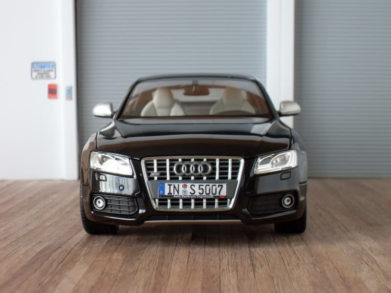

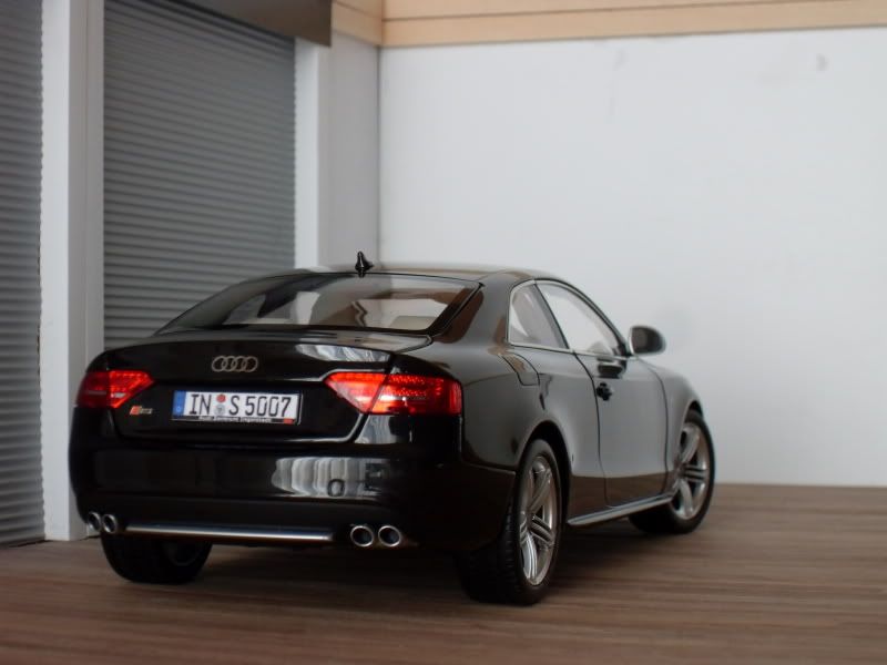

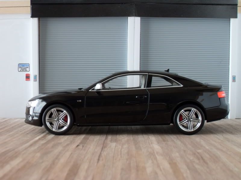

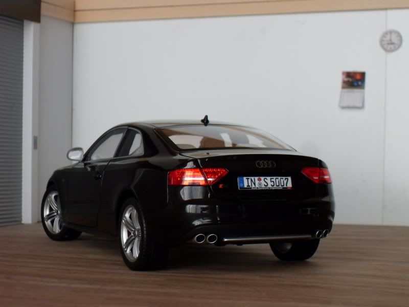

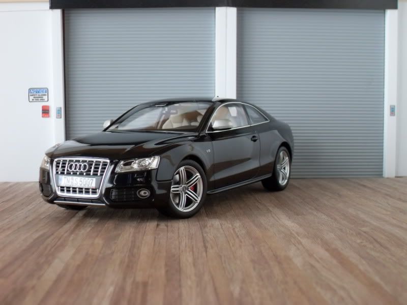

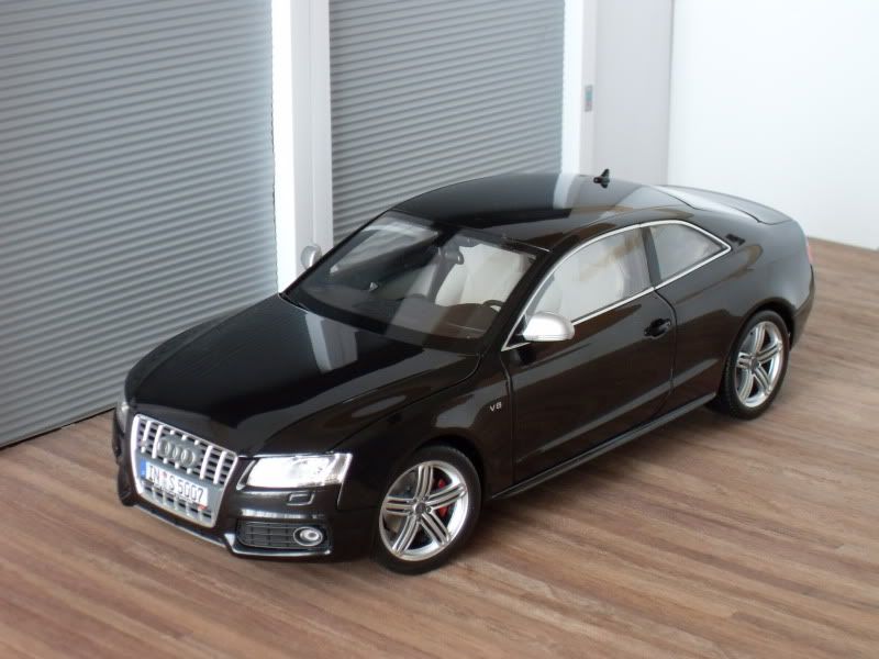

Well, I think it's a well known fact by now Norev really goofed the 1:18 Audi S5 release by installing the V6 engine and V8 badge, plus the dreaded 'off-road' ride height of the car. Nonetheless I bought one. It's actually a nice model. Proportion and pait job are excellent.

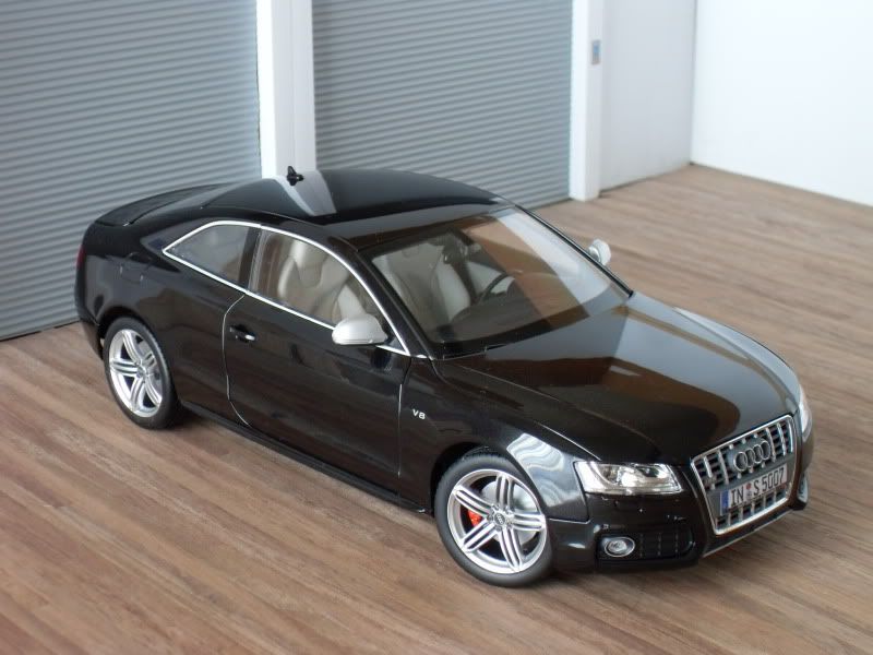

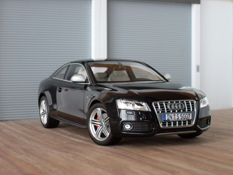

I ended up taking it apart and lowering it using some washers / small metric nuts as spacers. It's not really 'slammed' but this is as much as I can do without hacking anything up (i.e. no major modification). I think correcting the ride height really improve the look of this Norev S5.
Here are some pics I took earlier:

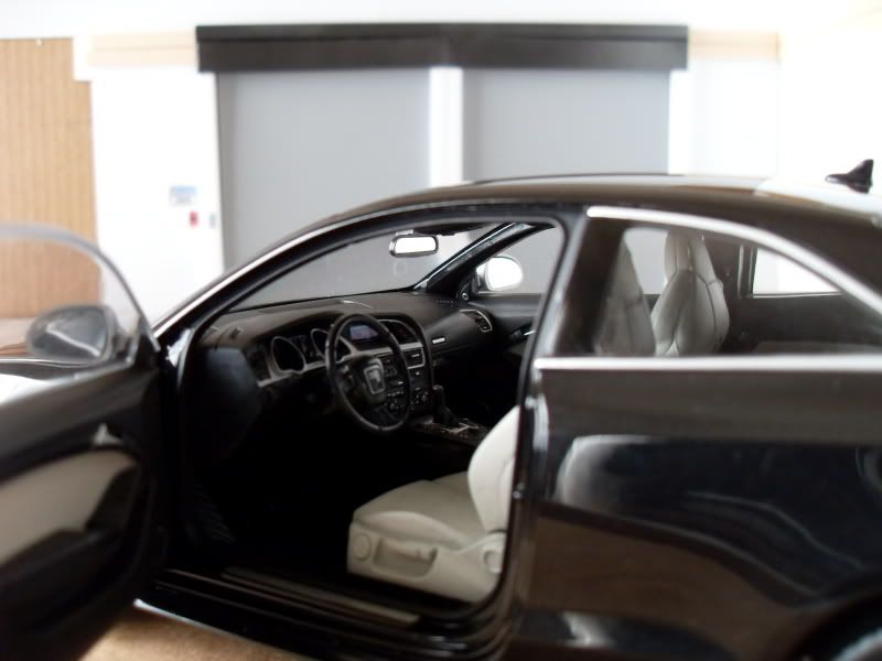

(I'm a little to annoyed to open the hood as it has the wrong engine.... or is it the wrong badge?)

That's more like it...but i agree with [KRAFTIG] that you could go even further!

Yup, I want to go lower too....

I'm still on the fence about this... the 3.0 TFSI in the car bothers me. However, the lowering has made it a bit easier to look at (going lower - as mentioned - would be even better).
Did you also paint the brake calipers red? If so, how easy were the wheels to take off?

This looks MUCH better lowered. Nice work. Like others here, I am really disappointed about the incorrect engine. However, I rarely display my models with the hood/bonnet up, so I don't think this will keep me from buying this car since the S5 is one of my favorite modern cars on the market.

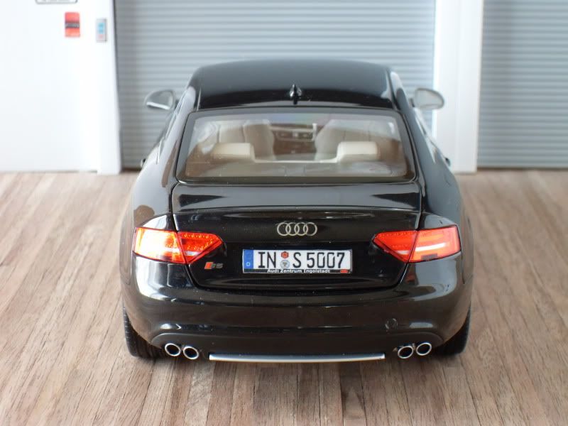

Did your copy come with German plates originally? I've seen some pictures of Norev S5s that have them and other pictures in which the model just has generic Audi S5 plates. I noticed you added custom plates with "Audi Zentrum Ingolstadt" frames as well. Nice job!

if i may ask how did u go by lowering this norev model?
I removed 6 screws (2 under the doors, the other 4 in the wheel well). For the front, I removed the spring and used small nut as a spacer between the steering knuckle and the lower control arm. I have to shave the LCA a little bit since it's rubbing the inner-bottom part of the wheel. For the rear, I just glued a washer between the control arm and the spindle. I hope that make sense.... I think it can be lowered even more but may require more modifications.
It had the IN-AF245 plate. I remade the plate and yes, I added the "Audi Zentrum Ingolstadt" :) I didn't think anyone caught that
