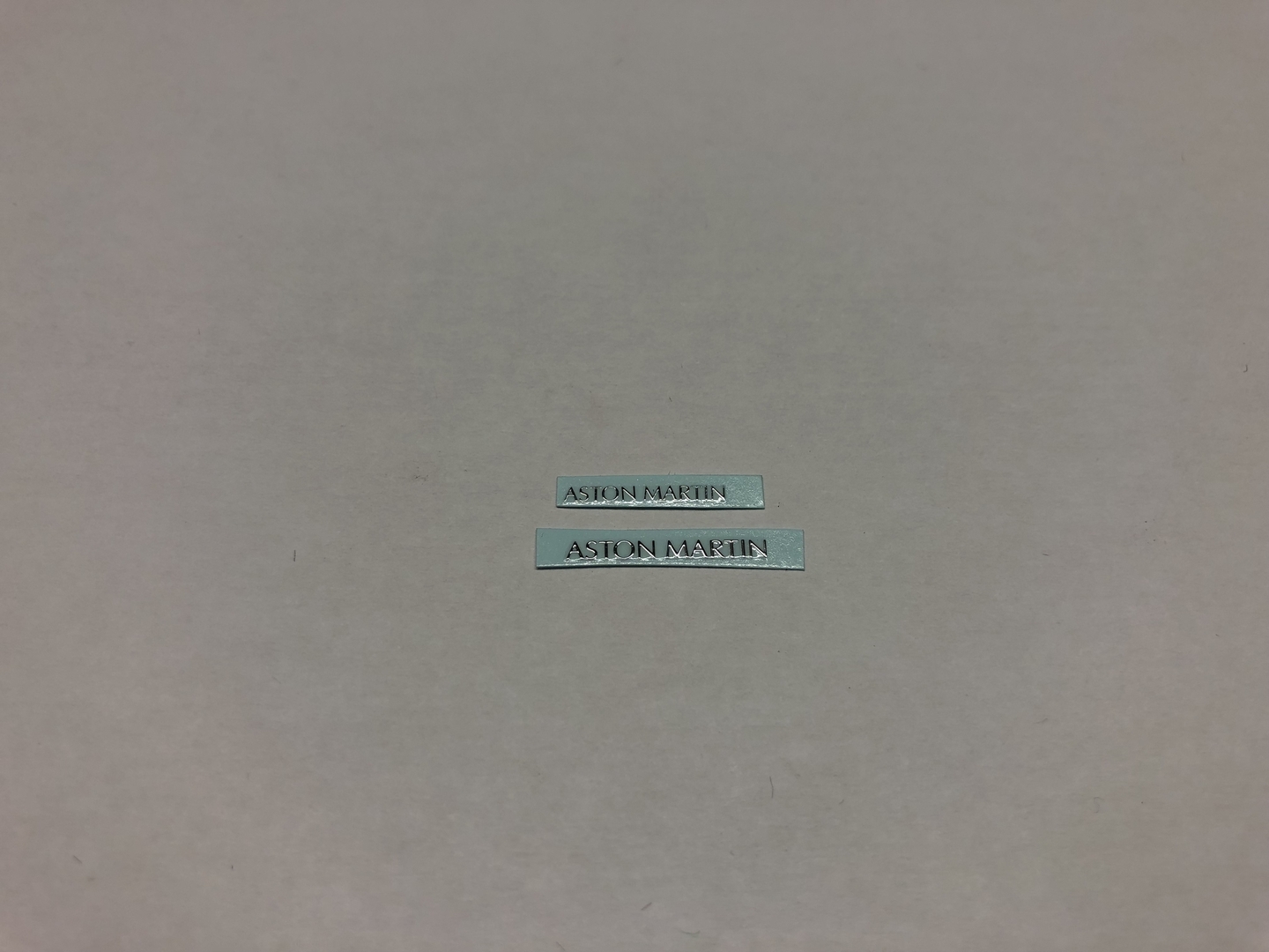

Nice project,
You called for Aston Martin logo's Mr. P. ?
Here you go :
Sincerely
Pascal

Many thanks Gents.
Another useful supplier added to my bookmarks Pascal. The decals are already on their way!

The doors handles on many of the DB4Zs were concealed mechanisms operated by a push button and I found these images by chance on Ebay. Hopefully I can replicate them (non working of course).
Font Rectangle Material property Auto part Gadget
Looks like the centre portion popped out when the button was pushed.
Wood Hardwood Metal Tool Rectangle
And an image from on a car.
Communication Device Bumper Automotive door part Automotive lighting Gadget
I'm not sure if any cars had the handles as supplied on the model as it comes. Some had a small loop that you could only get one or two fingers around with a push button to the rear to release the door catch, as shown in the image on the magazine above.
