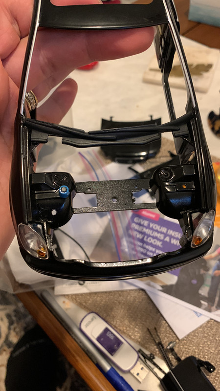

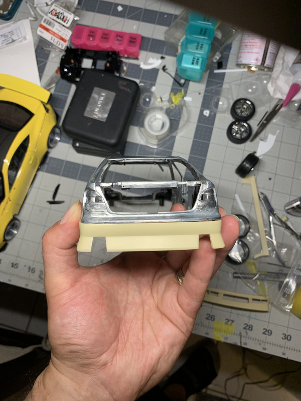

Tkdiecast recently released this kit so here we go.

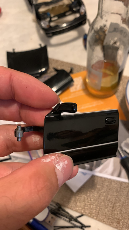

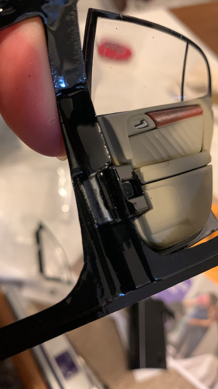

A few quirks about this model. The mirrors are part of the door
The hinge just slides out as opposed to being a swivelling mechanism

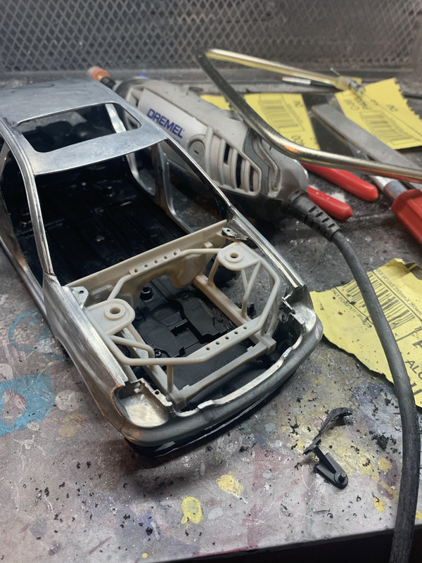

The engine bay has this annoying metal thing running across it.

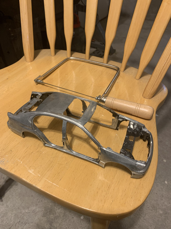

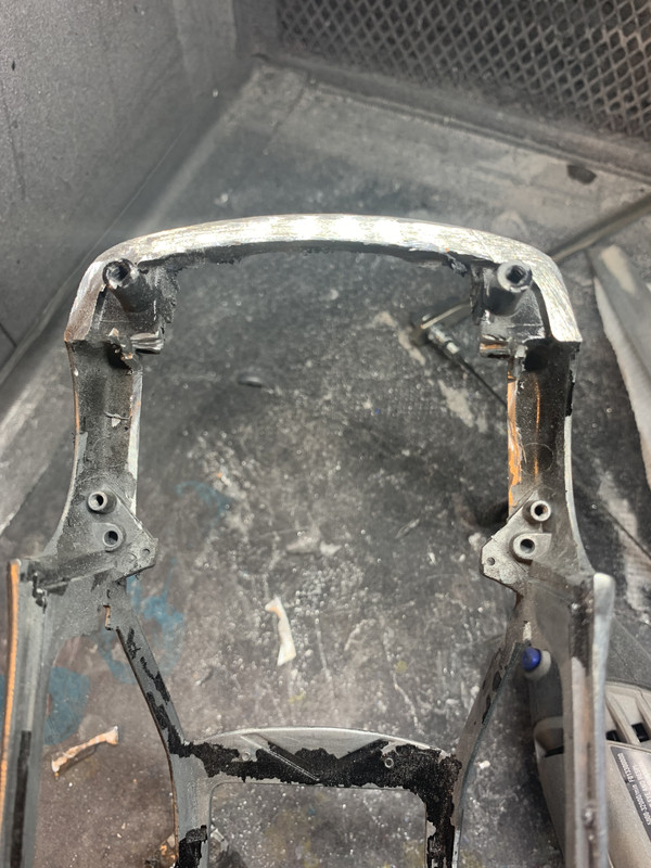

And into the stripper it goes.

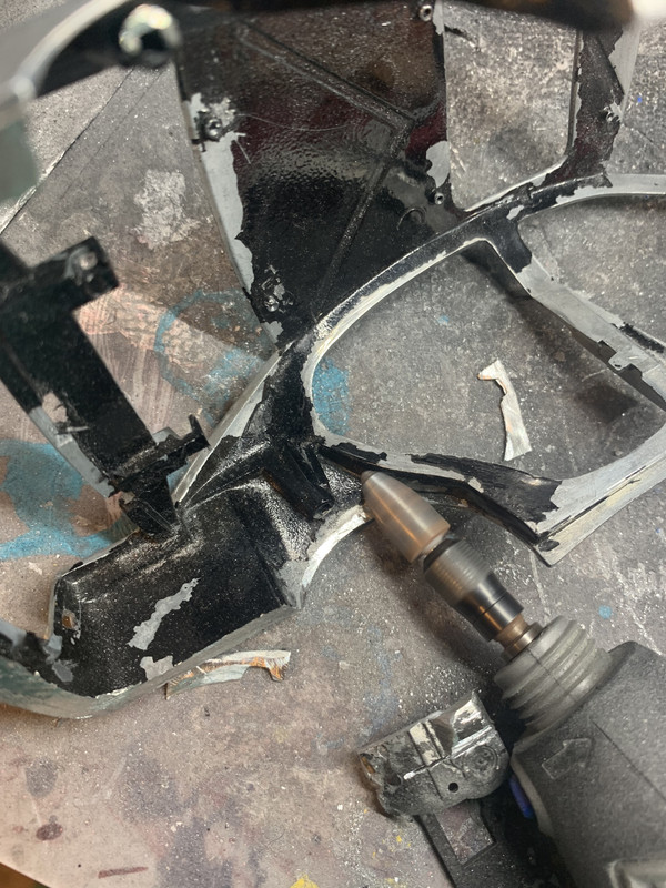

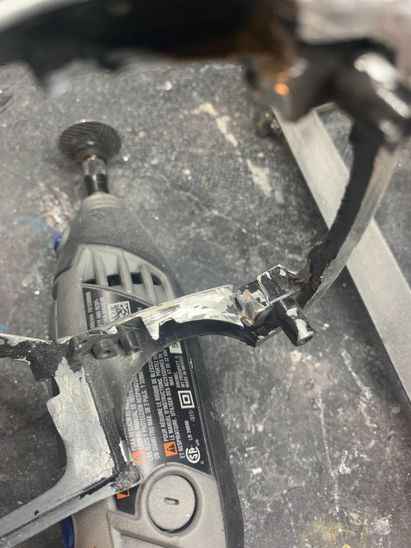

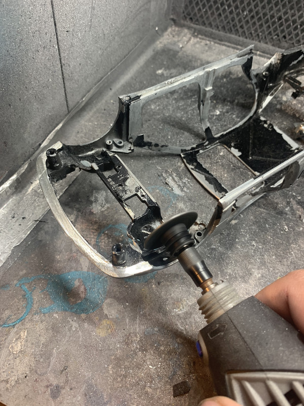

Time to cut.

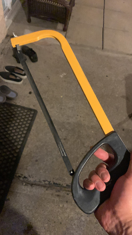

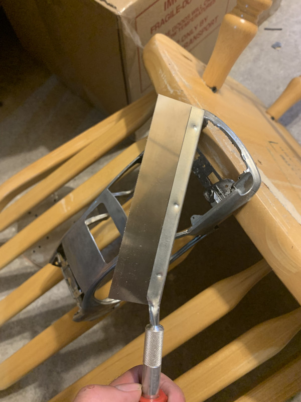

After an hour of cutting the blade finally snapped in half.
Tried this hobby saw - didn't work.
Tried this actual saw - didn't work.

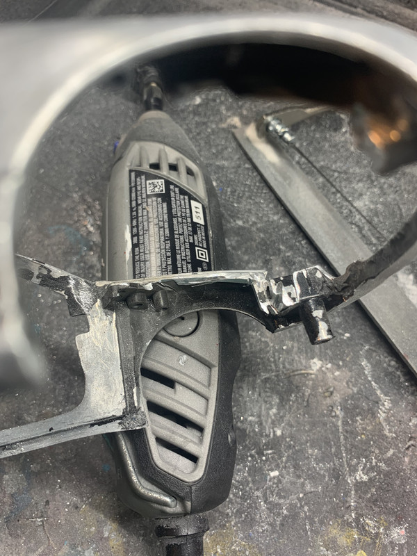

Finally went and bought a new blade for the jeweller's saw and cut it off. But just to give you an idea - this is how thick the front bumper was. The rear bumper was even thicker.

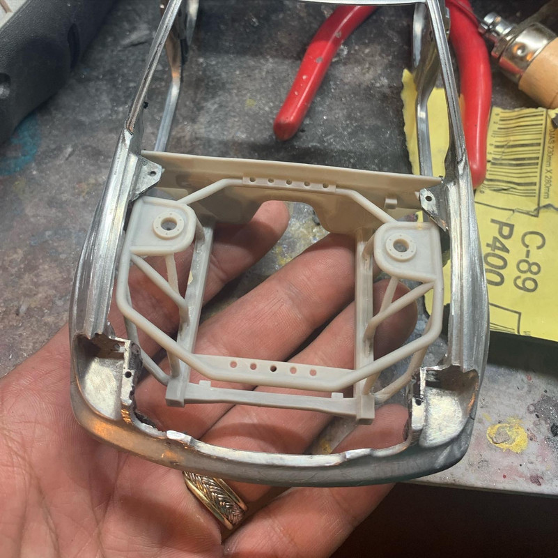

Then it was time to cut off that metal thing across the engine bay

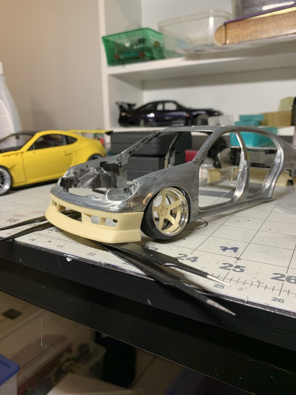

I also used this opportunity to make way for wheels by cutting away some metal in the wheel well and sanding the fender down from the inside.
Before:
After:
Sanding the fender from the inside
Trying the front drift subframe

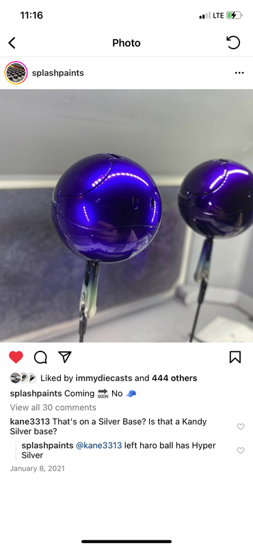

Paint will be candy purple from splash paint. One of these, depending on the base coat
