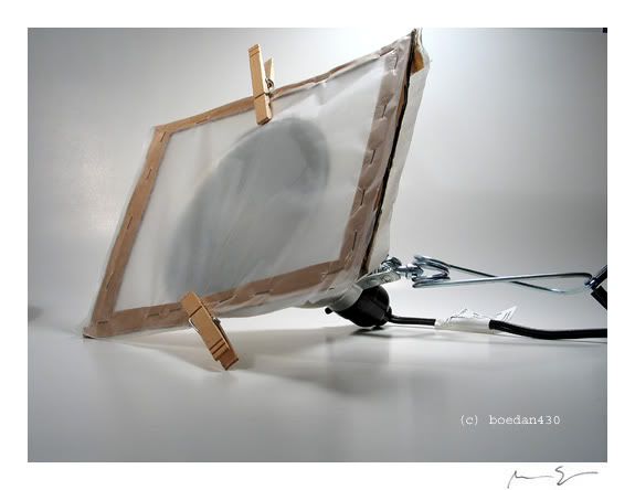

Okay with Souky's & Felix's talk & superb photos using light diffusers, I thought why not share our home made light diffusers.
They help stop glare/colour change of diecast when taking photos, aswell helps stop the extra glare when using a reflective backgrounds.
For myself I used some graph paper stuck to cardboard cut into small window frames and stuck to 50watt desk lamps, to get some good results.
Here are some of my results. "I have improved my photography so much in a short period of time, I did suprize myself, with thanks to all the great photographers here at DX"
So feel free to add your tips, ideas & results.

Can you post a photo of your light without it on?
:lol I now, makes me look like I can take good photos.
Here is the simply diffuser.

Mike,
Is that graph paper tyransparent or thin?
I have a similar light as you and notice that the glare is alway apparent and I would like to eliminate the glare.
Darrick its transsparent, I folded it x2, I was just playing around with different types of thickness till I got the results I wanted.
Waxpaper (stuff for baking pans) might work well in place of more expensive vellum or mylar.

Thanks for the inspiration Mike! I went down to my basement/cellar and found some leftover acrylic sheeting for light fixtures. It's got a diamond-shaped pattern to scatter the light so it might work for me.

This is much better than my first attempt. I cut out a couple of pieces of printing papers and taped them to my lamps. It was cool at first, but then I left it on too long (busy messing with the subject - trying to find good angles) and nearly set the lamps on fire. :eek:ops :lol I wised up and made those ghetto diffusers. :happy
So please becareful and keep your eyes on them. :cheers
