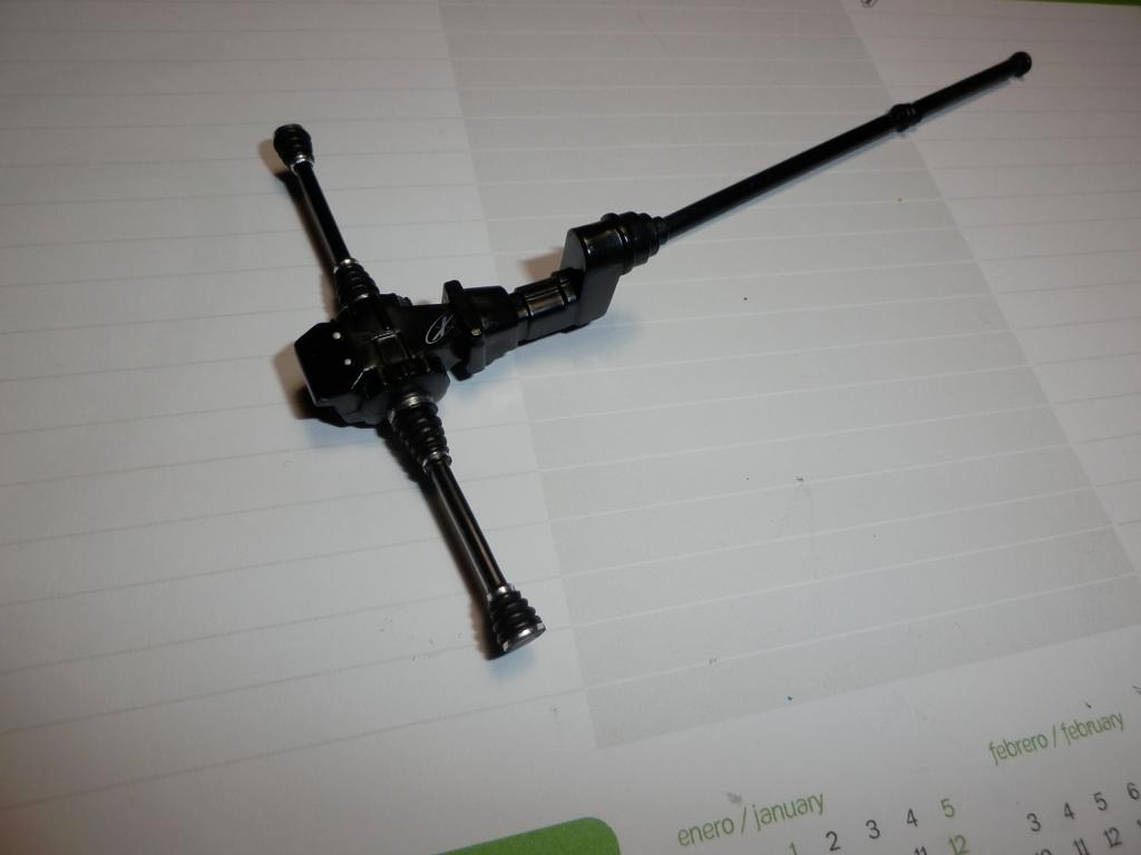

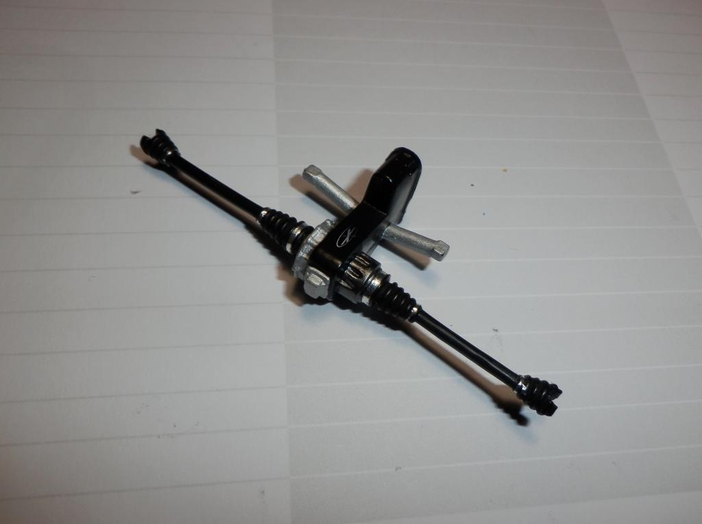

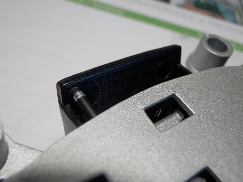

I detailed both differentials, including the bellows and respective clamps, bolts, chassis fixations (particularly the rear diff, in which the brackets are supposed to be part of the ASF space-frame):

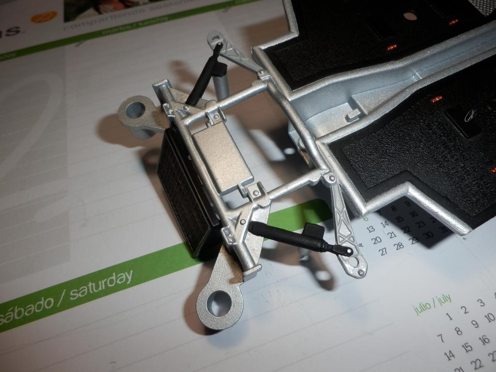

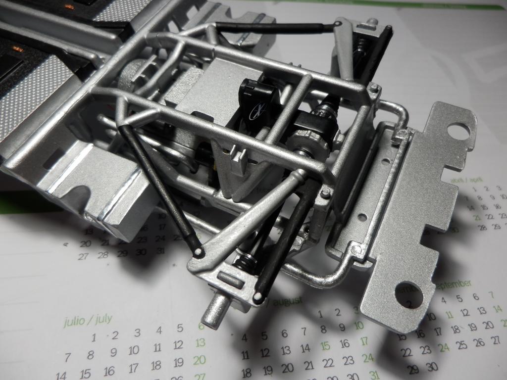

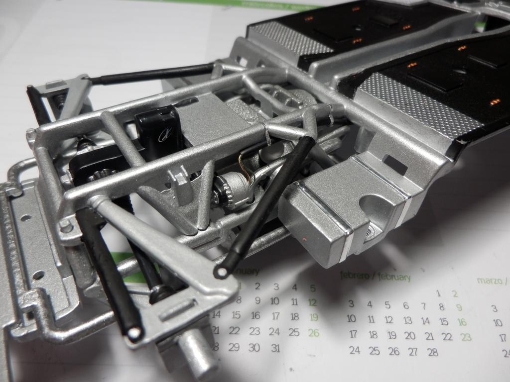

The space-frame is now painted fully in aluminium except the belly plates which I sprayed matt black in order to simulate the corrosion insulation usually applied. Since I was at it, I also gave it a bit of colour painting copper the seat fixation points and added the tank straps which I did in aluminium duct tape:
Front and rear suspensions painted in metalic grey and the control arms matt black. Next up. the coil springs:

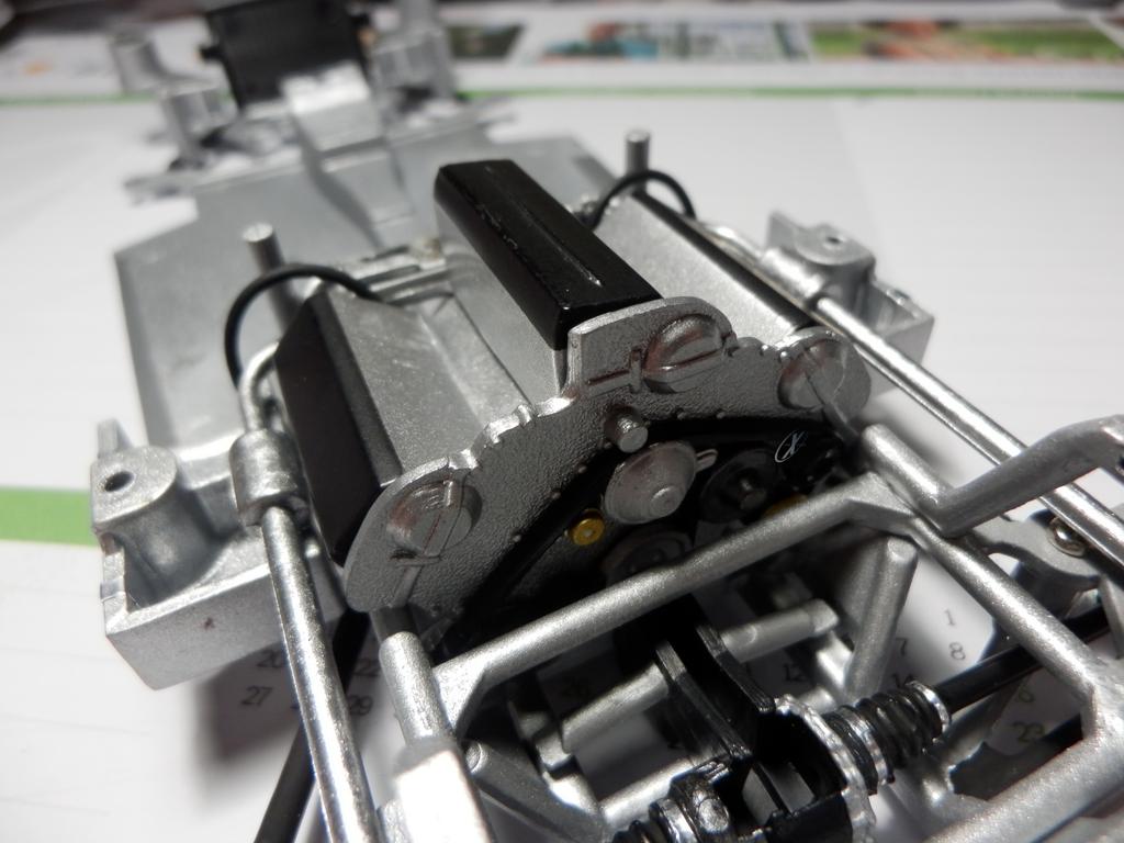

As for the engine, after giving some colour to a few components that were just black plastic (as was the case of the starter motor, oil filter and alternator), I added a few more cables and pipes to add a feel of more detail. Only the brake lines are missing, now:
After digging up some rare photos of the complete W12 engine, I noticed the valve covers were painted black. Although that isn't visible after the car is assembled, I did the same to the model's engine so that the cylinder rows weren't just "grey parallelepipeds". The auxiliary belt pulleys were also painted as on the original:

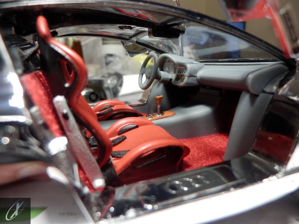

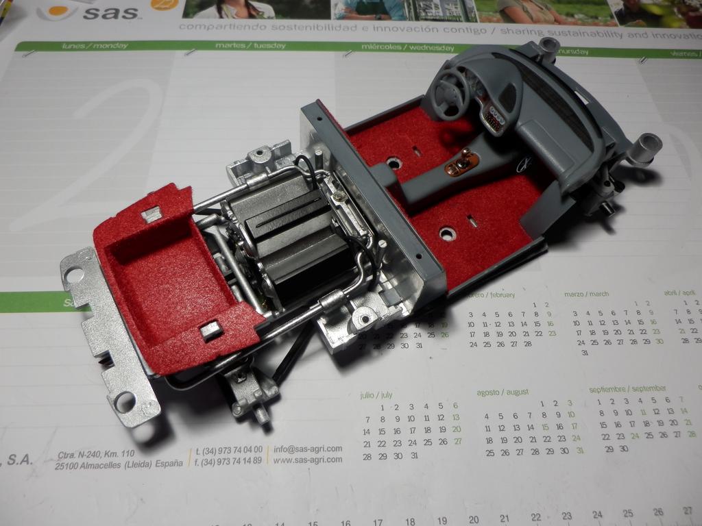

On the interior, a bit of flock in good measure:
The cabin floor was flocked bright red according to the original and I took the chance to eliminate a few mould marks from the dashboard and steering wheel:

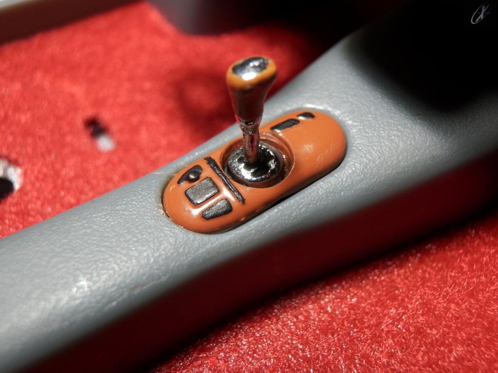

The gearshift knob was all chrome so I added a bit of brown paint to simulate the original wood handle, added a bit of depth to the shifting gate and added a bit of black the the buttons on the console:

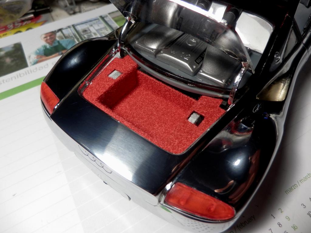

The trunk was also flocked with the cabin:

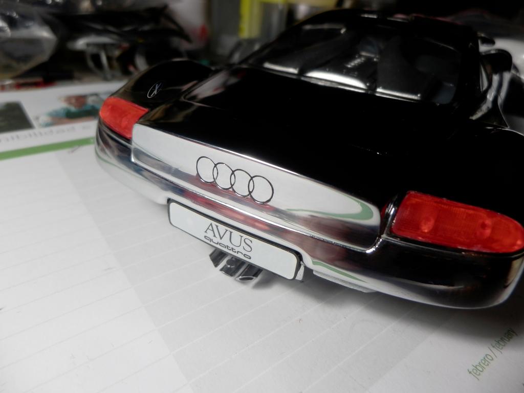

The Audi logo at the rear is pressed-in the panel and I painted it black as on the original:

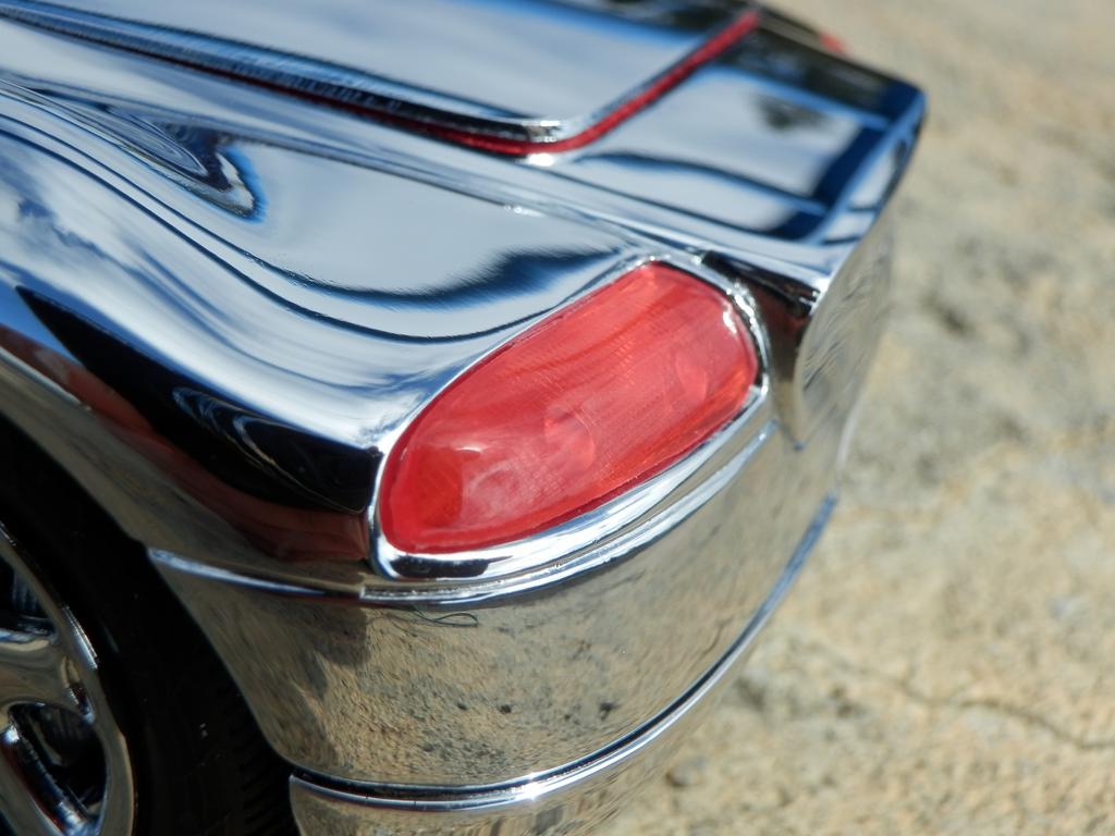

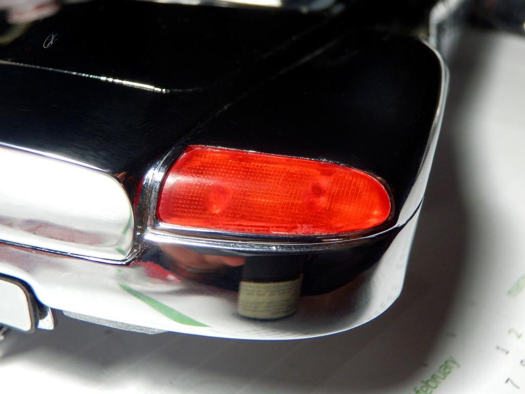

Deleting the taillights fixation pins:

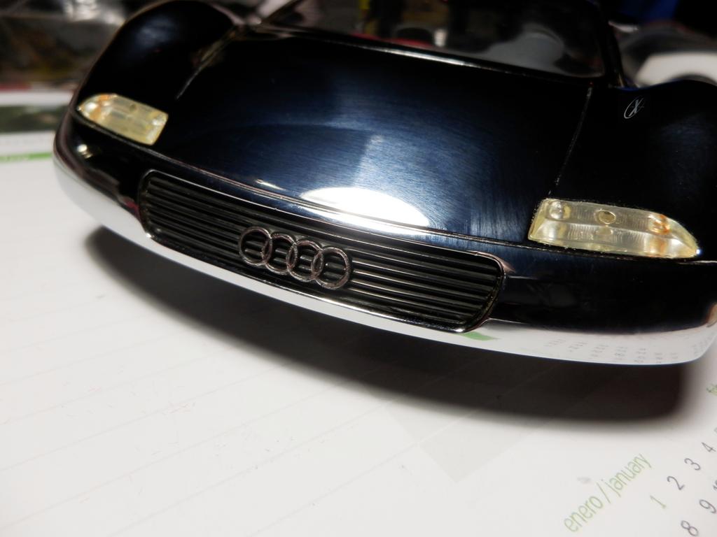

And I straightened up the front grille:
825 Posts

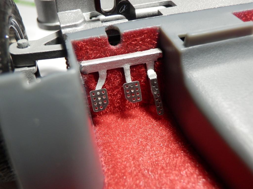

I'm getting there. I replaced the original plastic pedals from a photoetched set I got from Tremonia:

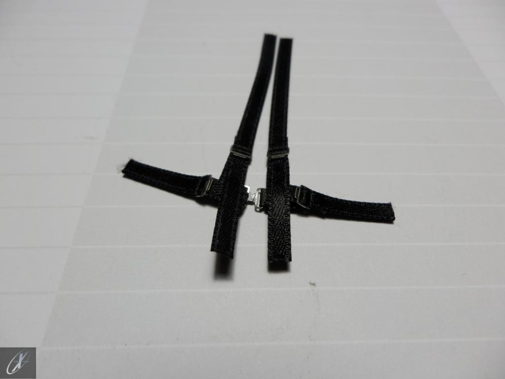

While the seats are drying up from their new re paintjob, I took the time to build the 4-point safety harnesses (once again, from Tremonia):

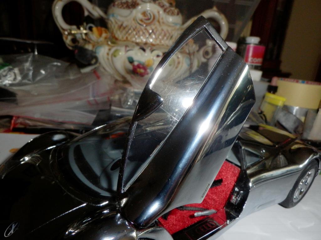

The doors also have windows, now:

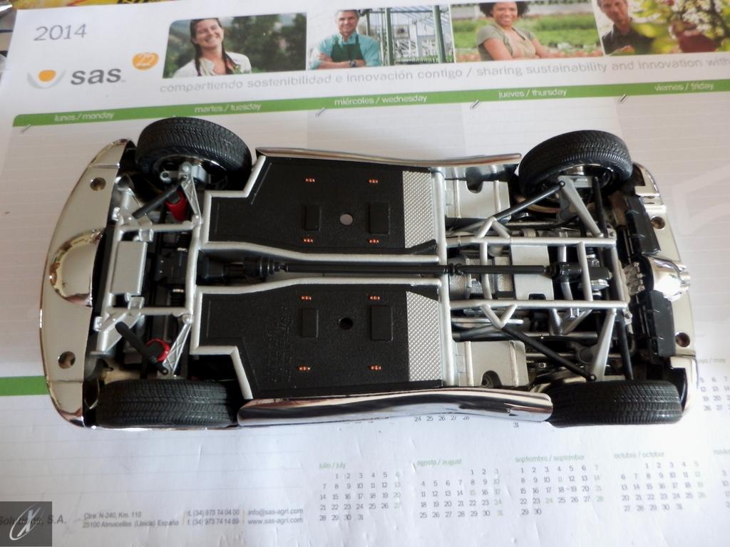

Chassis and drivetrain are finished and include the brake lines:

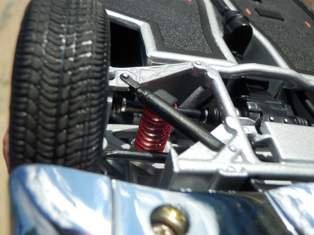

Final stretch. The rear suspensions now have new coil-over-spring sets, I almost feel like leaving the bodywork aside:
The seats were resprayed a brighter satin red and the back are now matt black, in order to imitate the carbon fibre shell and the lateral adjustment strut was painted aluminium, leaving the backrest inclination knob black:
Four-point safety harnesses with cloth belts and photoetched buckles. Greetings from Tremonia:

Rolling chassis:

Can you give more info on the door glass?
Yes, indeed! The door windows were made out of clear acetate sheet, made a template out of paper and cut the acetate to fit and added a lip so that it can be "tucked in" under the door trim panels.

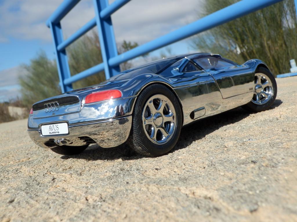

Just bolted the bodywork back on and it's pretty much finished!!

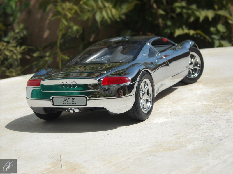

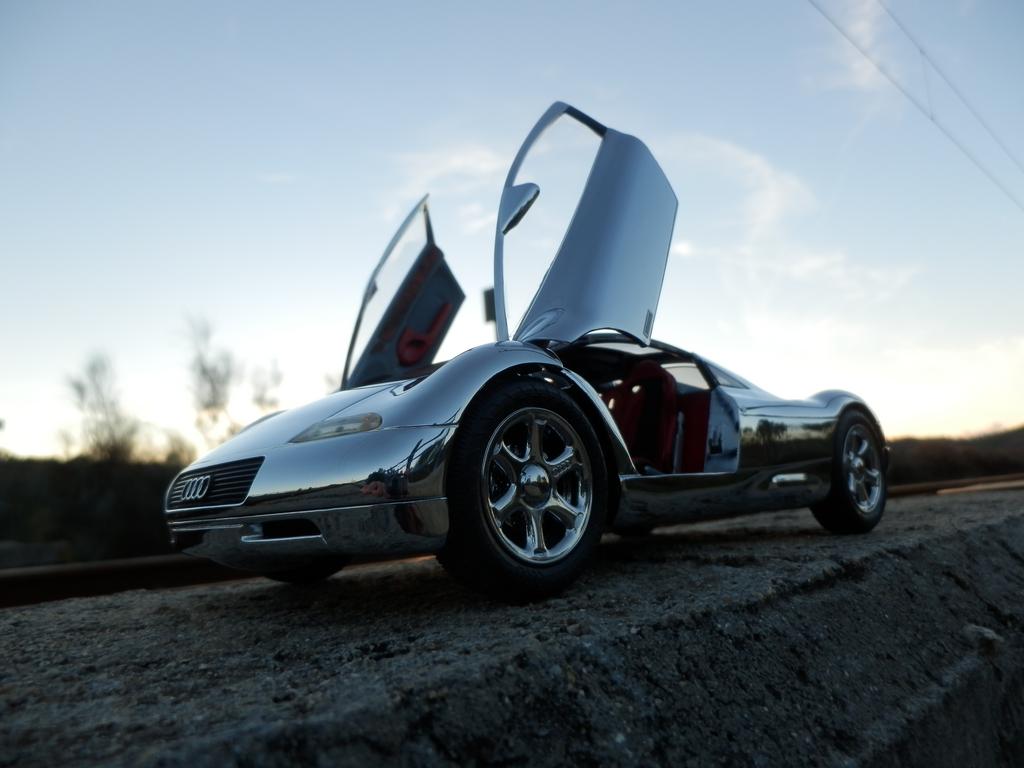

This is the finished model:
