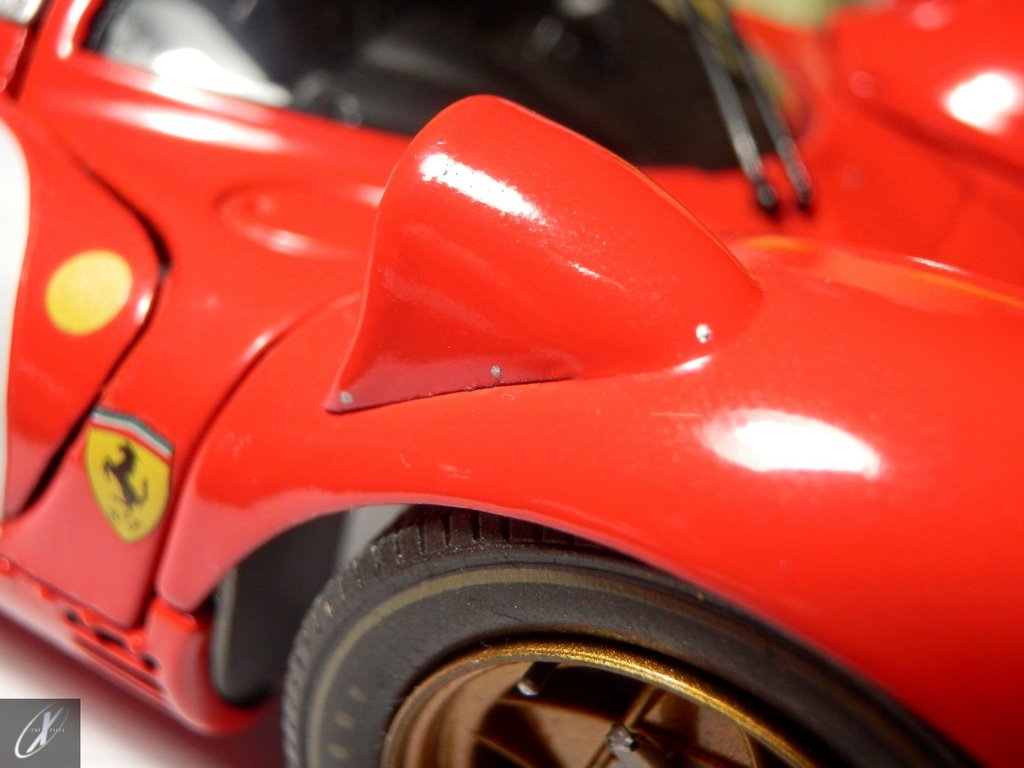

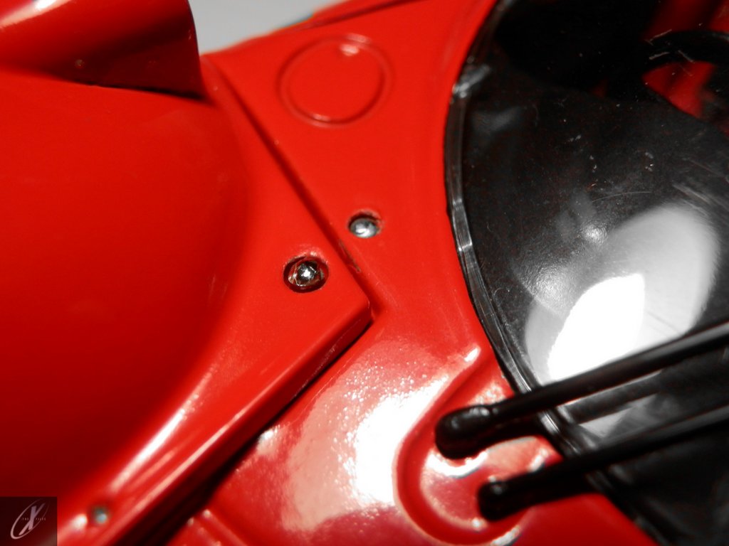

I simulated the rivets with which the rearview mirrors were attached to the bonnet on #0858. I will be buying some sticker chrome rivets for a better look:
I removed the rubber latches the model originally (and incorretly) had to close the front clamshell. Originally, the car uses flat head bolts to keep the clamshell in place. Therefore, I covered the holes with small pin heads that I think look OK. Also added the tyre callibration weights with a bit of aluminium tape:

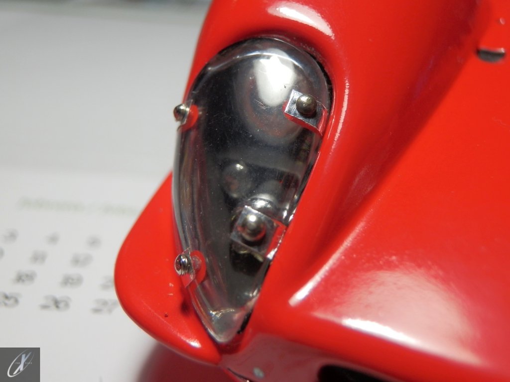

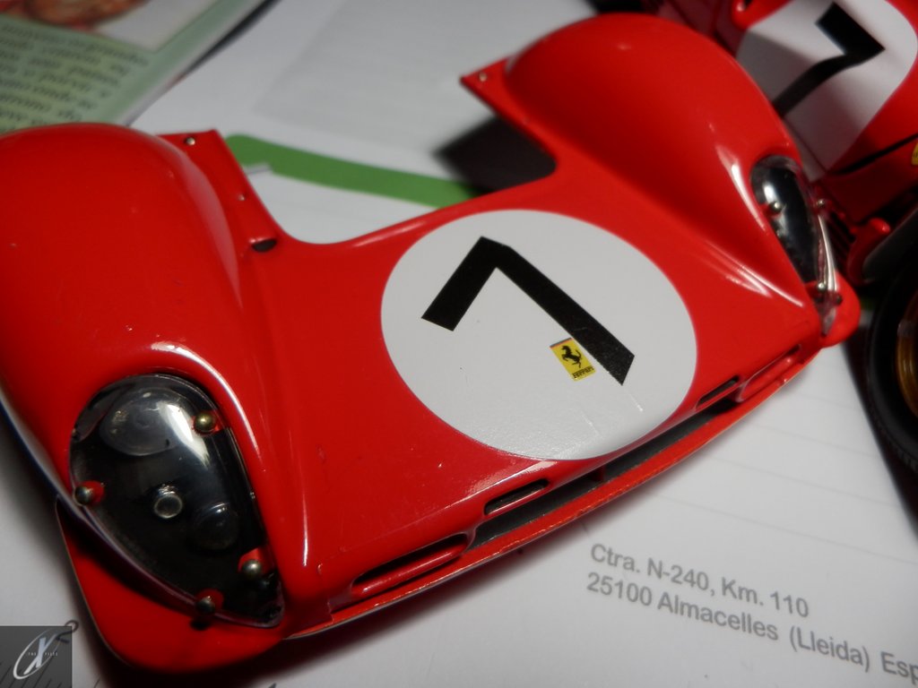

On the reference photos i found of #0858 at the 1967 24h of Le Mans, I noticed the fixation of the plexiglass headlight covers was made with a kind of metal clamps bolted to the covers so I did those with a bit of aluminium tape and the smallest pin heads I could find (which aren't all that small). Maybe will be swapping them later:

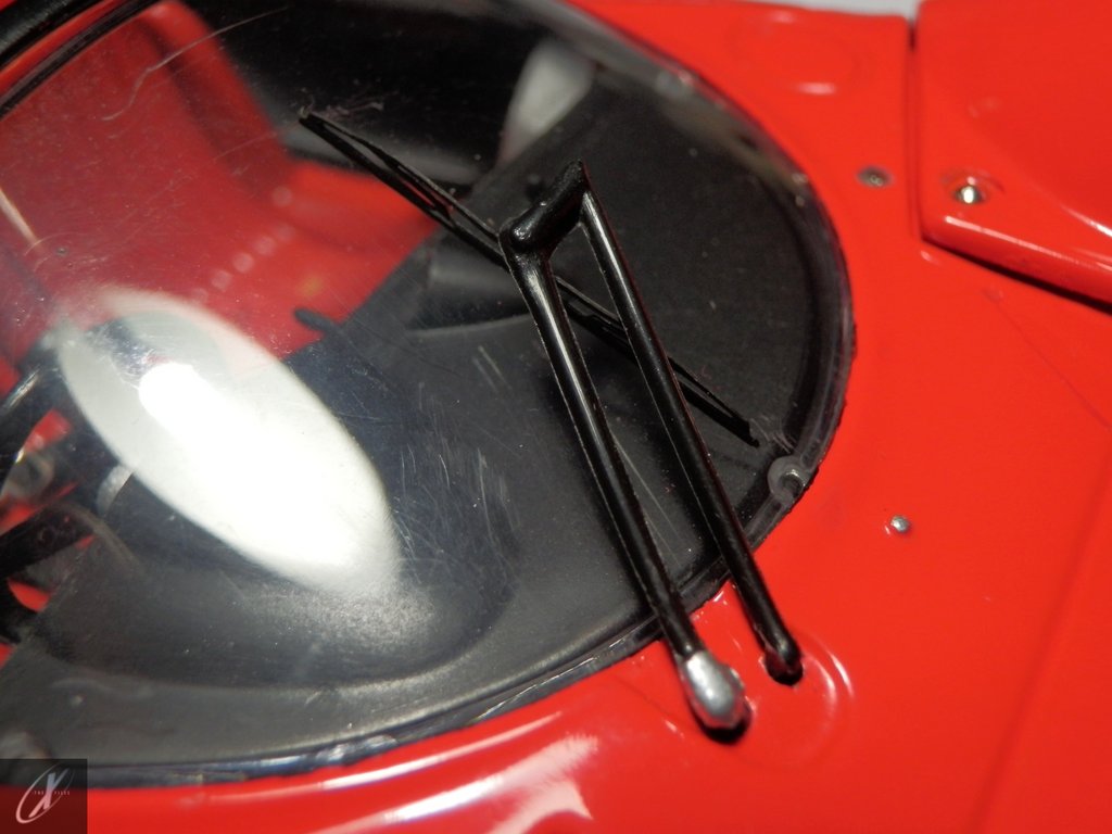

I replaced the windshield wiper blades with ptohoetched ones that I got from Tremonia. Also painted chrome the base of the wiper stem on the #0856 as seen on the original car:

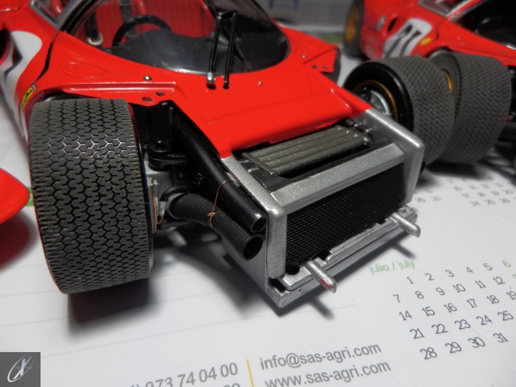

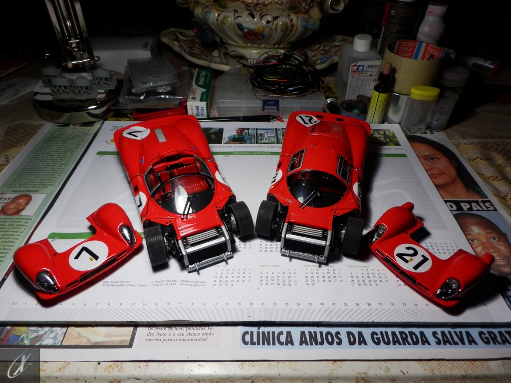

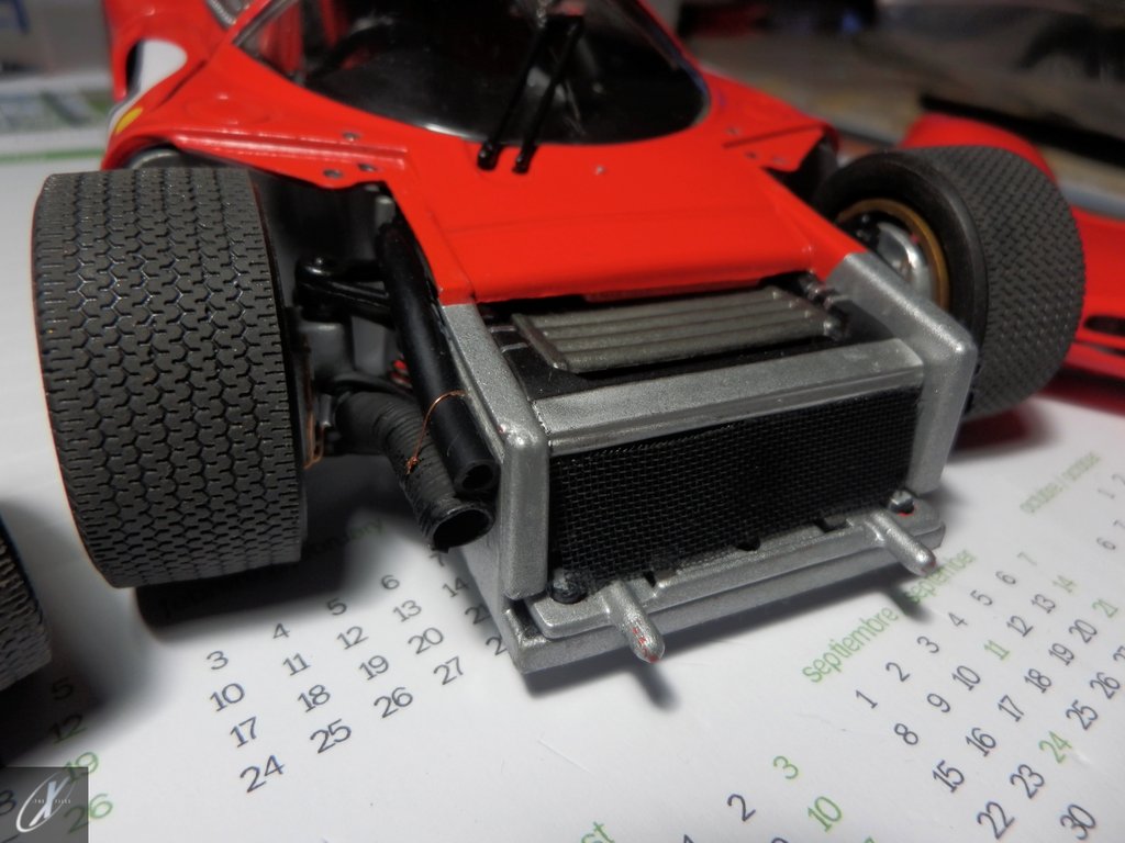

Removing the front clamshells one can see the revised radiator (I did the core with plastic mesh sprayed matt black but I just found a nice photoetched radiator-pattern mesh that I'll be replacing these with) and the cockpit ventilation and brake coling ducts:
#0856' sfront clamshell. I applied 3 layers of clear coat over the Ferrari badge so that it has a glossy finish and protrudes over the number decal:
The cockpit ventilation ducts (upper, thiner and smooth ones) were done of 4 mm electrical wire insulation tube with the core bored out so that the walls are thiner. The brake ducts were made of thin copper wire wrapped tightly around a thick tube and afer removing this, moulded into position and then painted with a thick layer of matt black Tamiya paint. For me this is the solution that I found to produce the best results on reproducing braided hose:

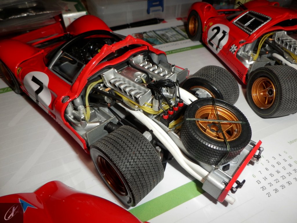

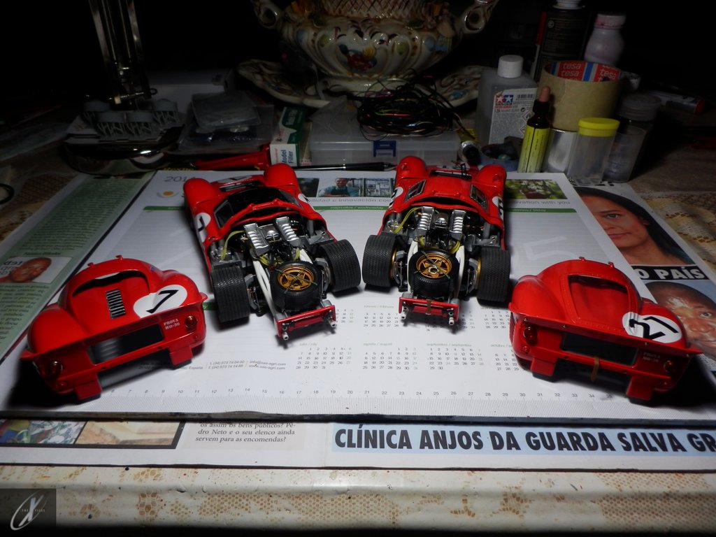

#0856. The rear brake cooling ducts were made with the same technique I used for the front units. I also added the rear suspension trailing arms, the coil-over damper units, anti-roll bars and respective control arms. Only after the entire rear sub-frame and drivetrain are in place I connected the coils to their respective distributors:
#0858's engine. Same thing:

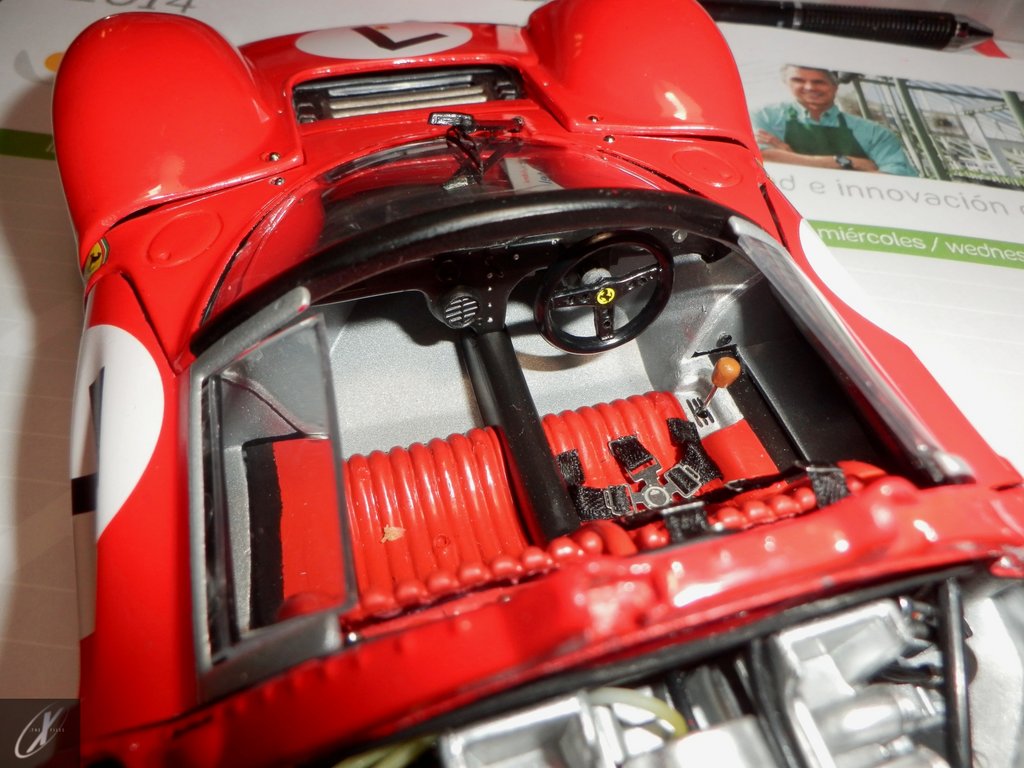

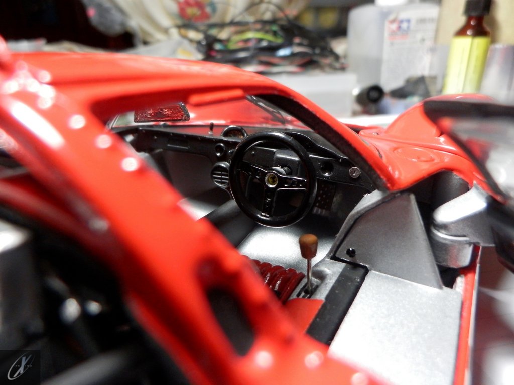

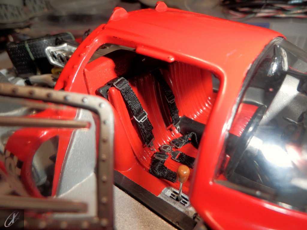

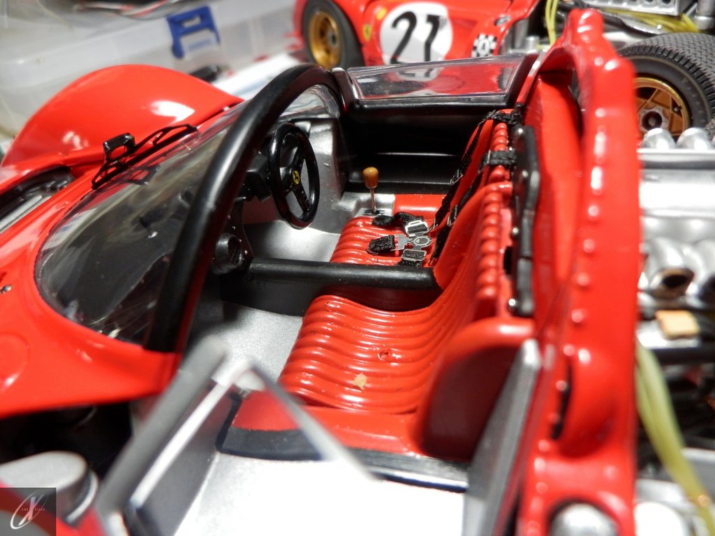

#0856's cockpit. I'm soon receiving a donour central rearview mirror but I can close the car since access is easy. I replaced the gearshift lever with a thinner one, made from a pin and the original knob:

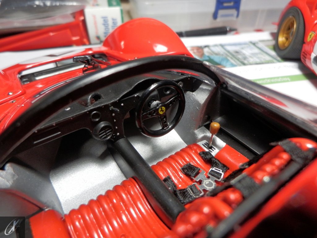

#0858's cockpit. Pretty much the same work done in #0856 but since it's easier to access the cockpit before closing the car up, I attached the rearview mirror I had on this:

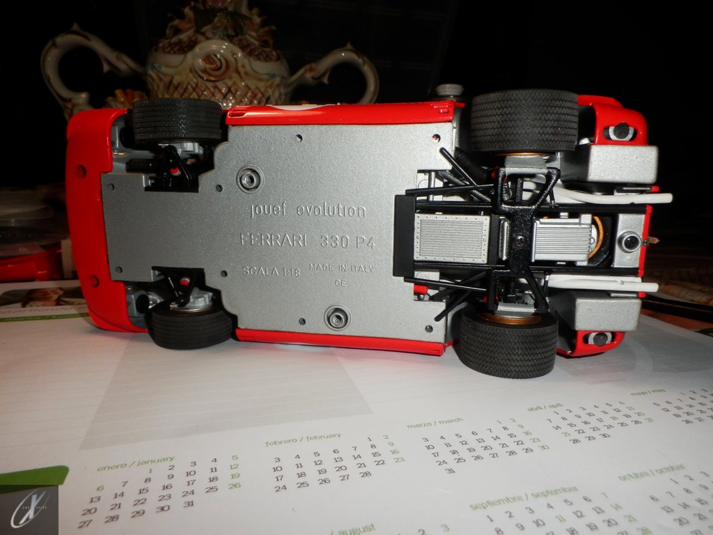

The finished undercarriage. It surelly won't look remotely as good as @P A D's but Still I think it looks way better than before. On this view one can see the coi-overs better an the added oil filter on the engine's right-hand side:
I will be making a complete photoshoot on these two real soon.

One comment re the air valves where you mention using 1mm wire. If you scale that up, they come out at 18mm. I measured a valve on my car and they are about 9mm, so 0.5mm wire would be better. I use 1:20 resin valves from Spot Model which are just about right. If you are considering changing the pins on the headlight covers, check out the Prime Miniatures website I gave you earlier. They do some very small brass rivets that might be suitable.
