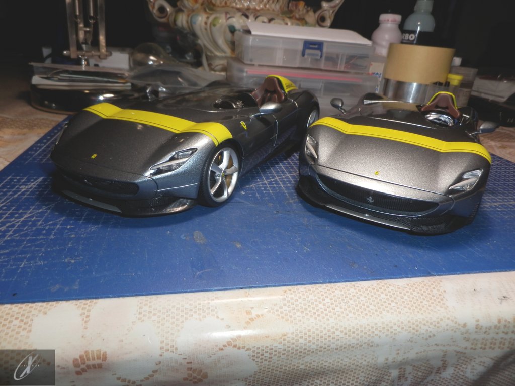

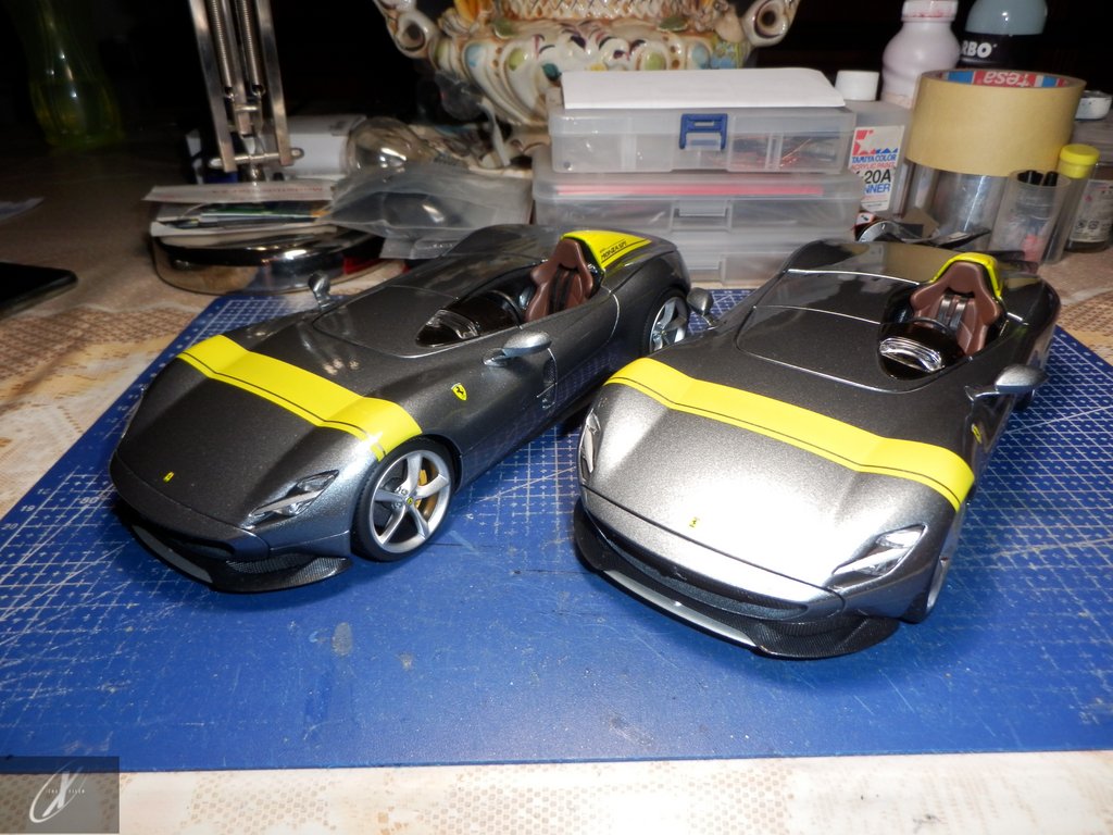

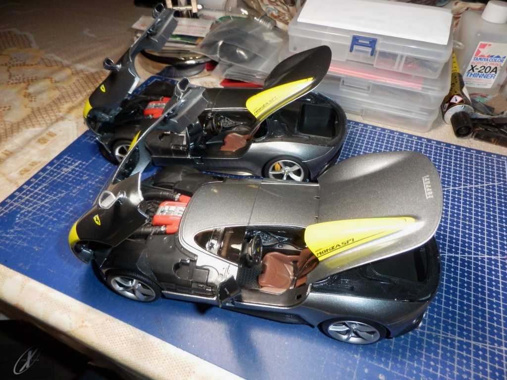

While I wait for the Pininfarina decals to arrive so I can definitively end Aurelias, I get myself into another project, I hope it will be much faster than the previous one. This time, another pair of now younger italian ladies: two Monza SP1. The Bburago is rather decent but there are a handful of details that could be improved, namely:
  • Add photoetched logos and letterings;
  • Paint the interior of the panels and engine compartment matt black;
  • Paint black the strips around the cockpit;

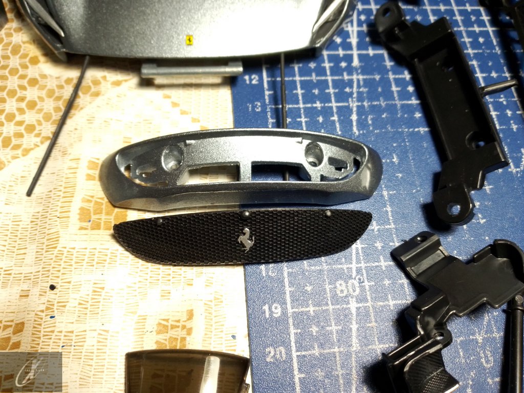

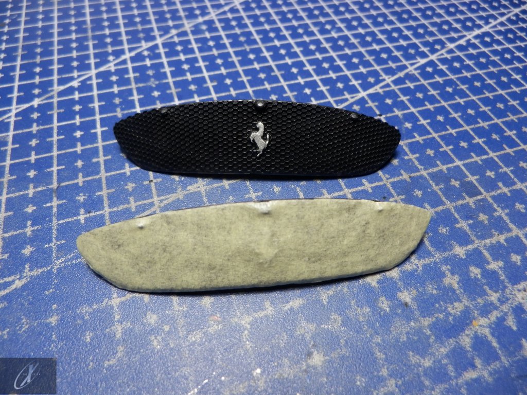

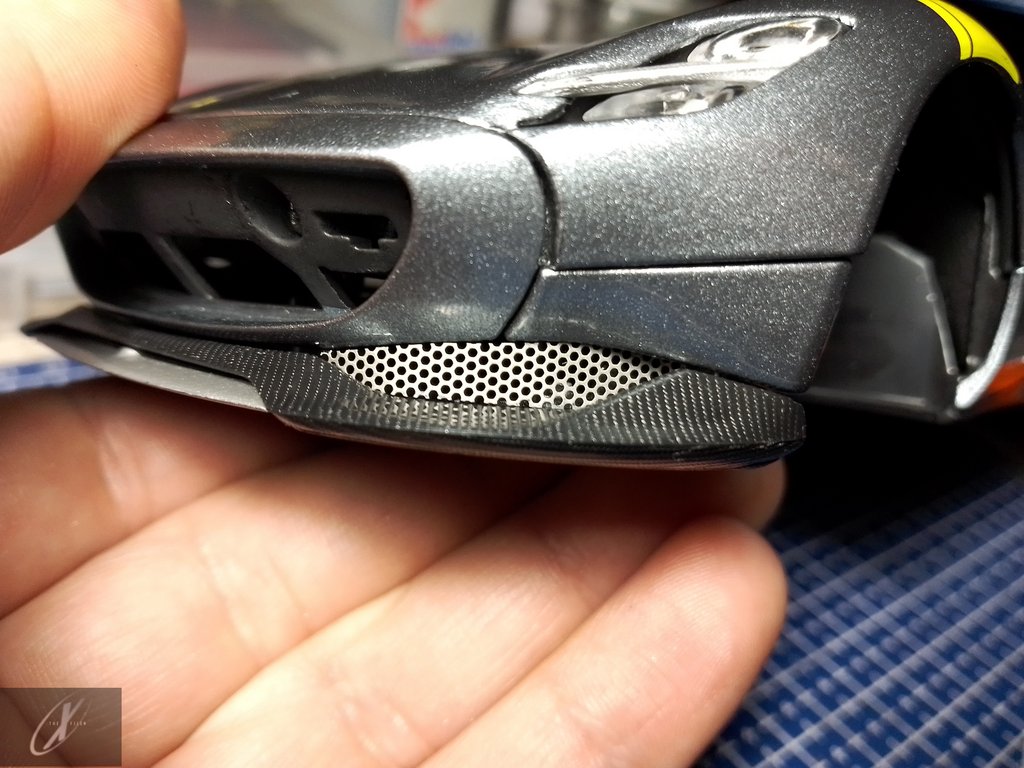

  • Add metal grilles at the front;
  • Add brake details;

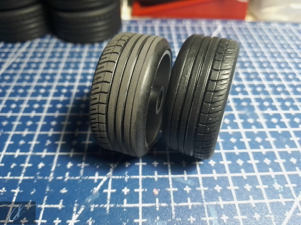

  • Sand the tread of the tires;
  • Paint the bottom of the passenger compartment in a metallic tone;
  • Detail the interior (paint the pedals aluminum, open the ventilation outlets, apply clear coat to the gauge cluster, paint black the seat backs, etc.);

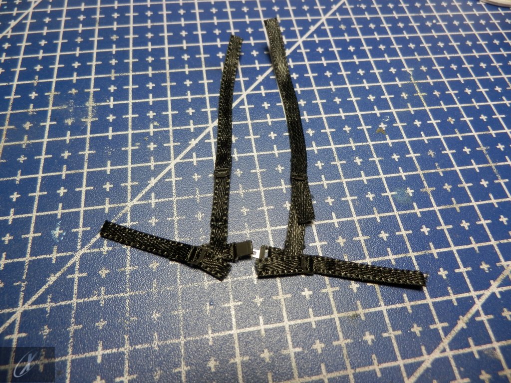

  • Replace the plastic belts with a fabric and photoetched belt harness (Tremonia);

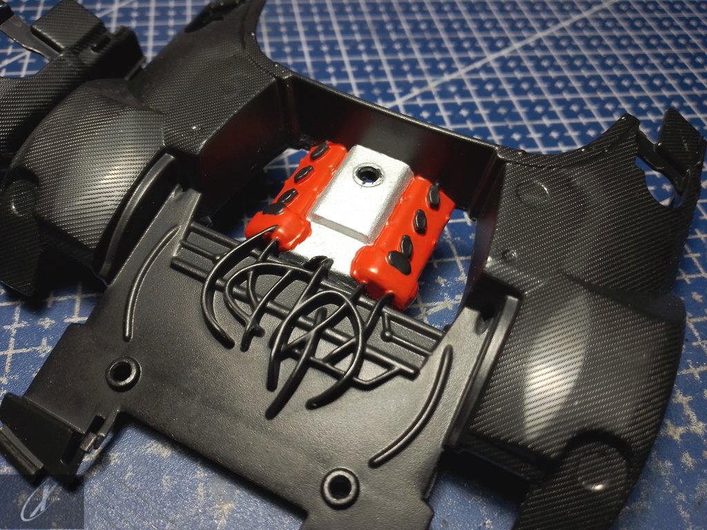

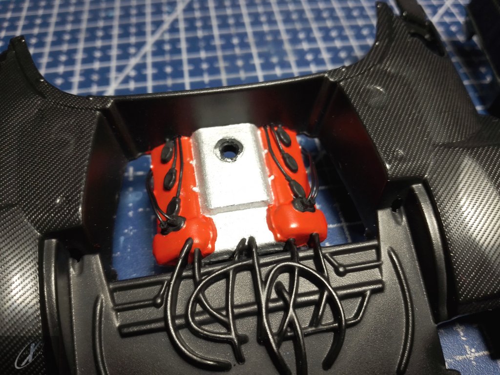

  • Detail the engine (cut the bottom of the mold for greater depth, paint red the valve covers, add wiring and clamps, etc.);
  • Flock the luggage compartment;
  • Add shock absorbers to the boot lid;
  • And everything else that comes by!

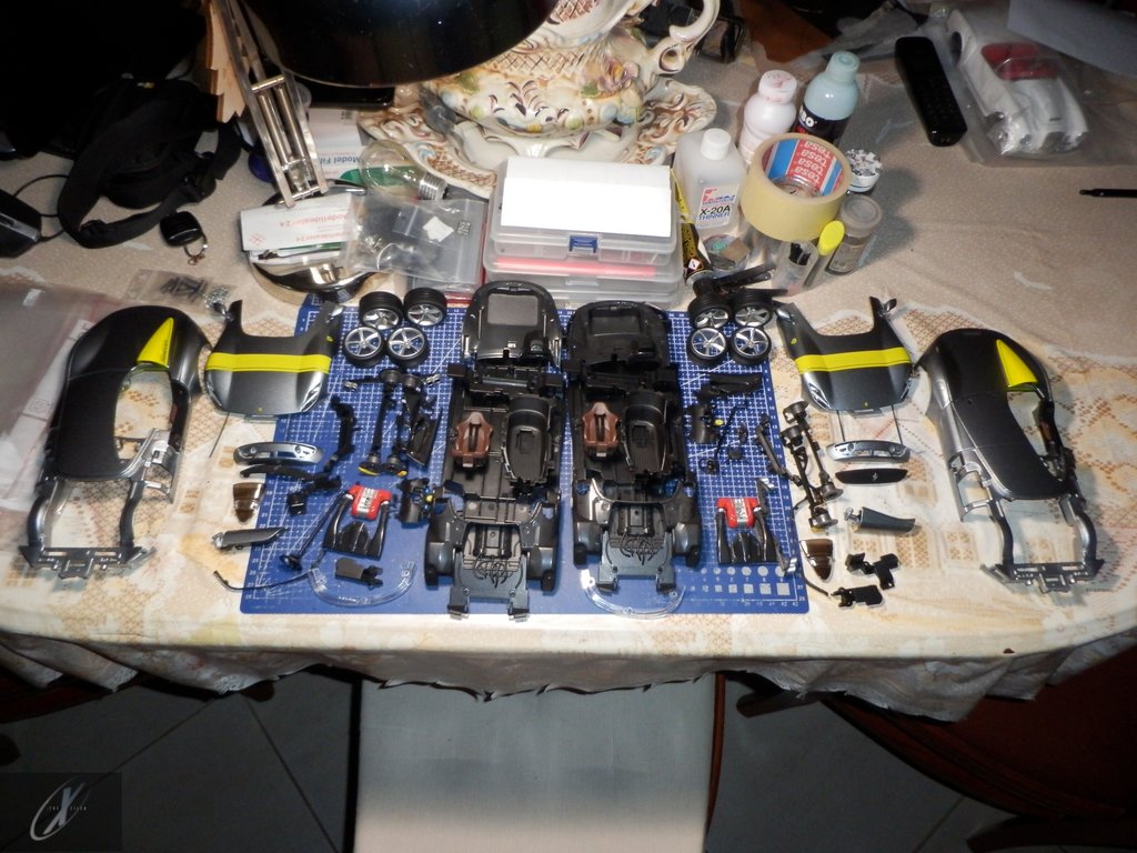

Everything stripped down:

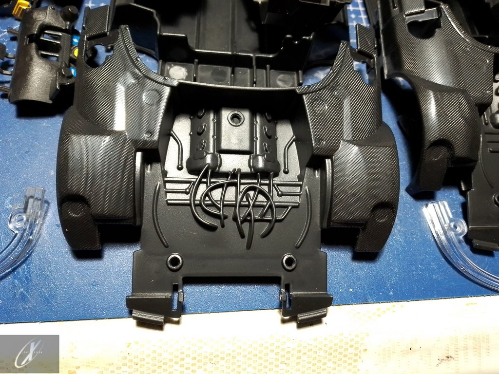

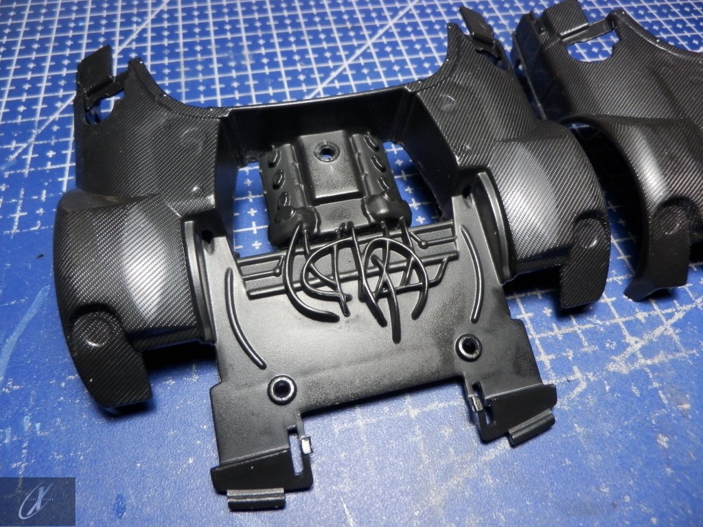

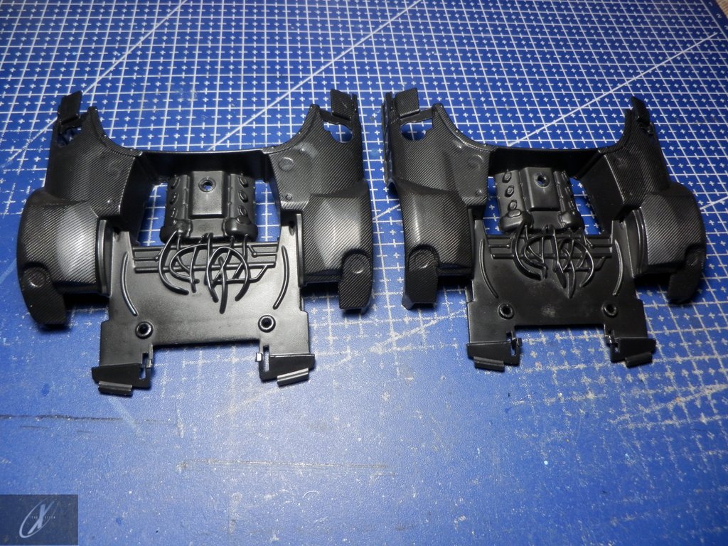

The engine and the carbon fibre "beauty" panels ann in the same mould:

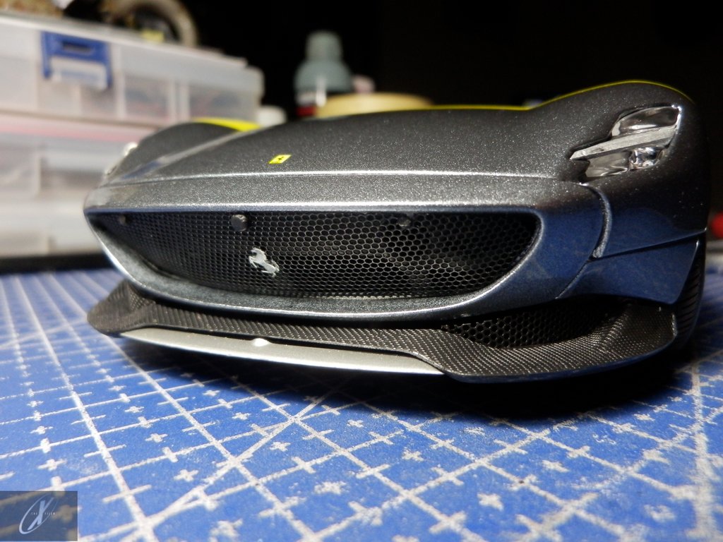

The huge front grille hides a few (small) openings:

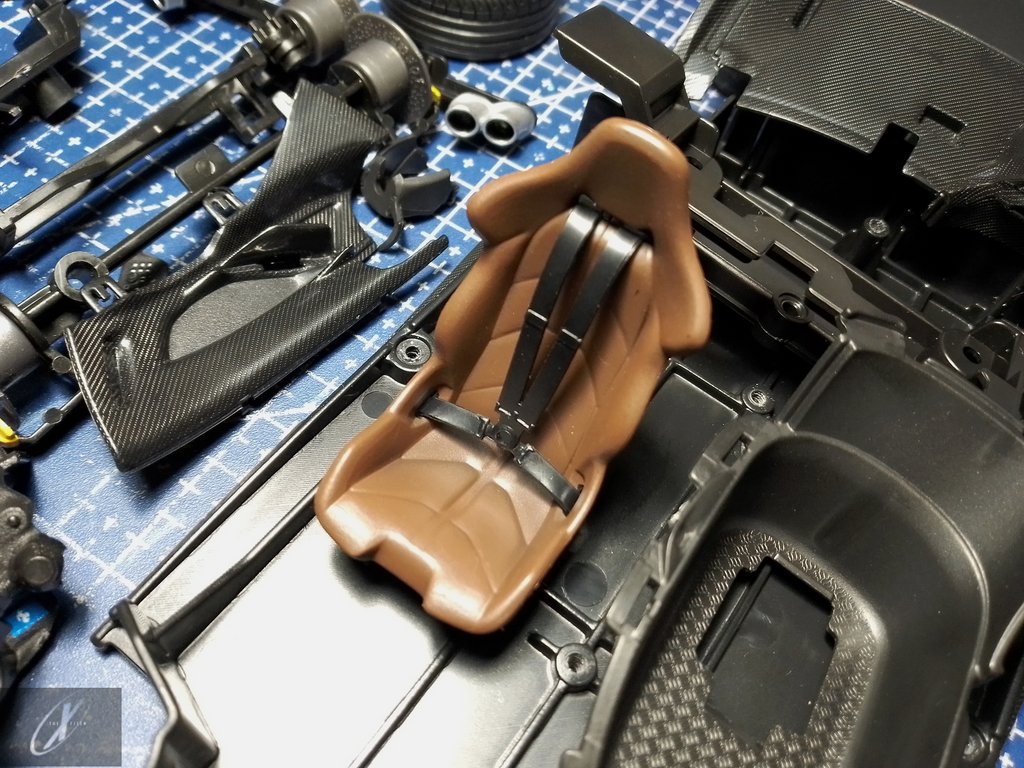

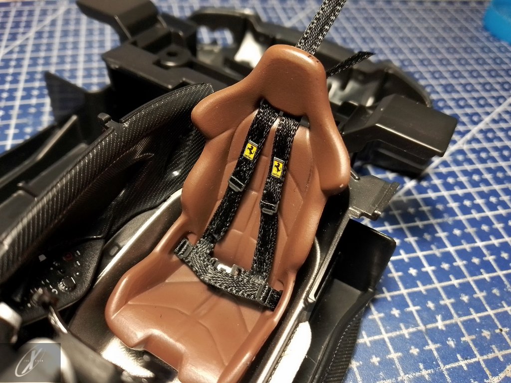

The seats with the plastic seatbelt harness (clearly taken from Maisto's parts bin):

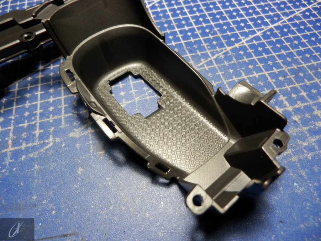

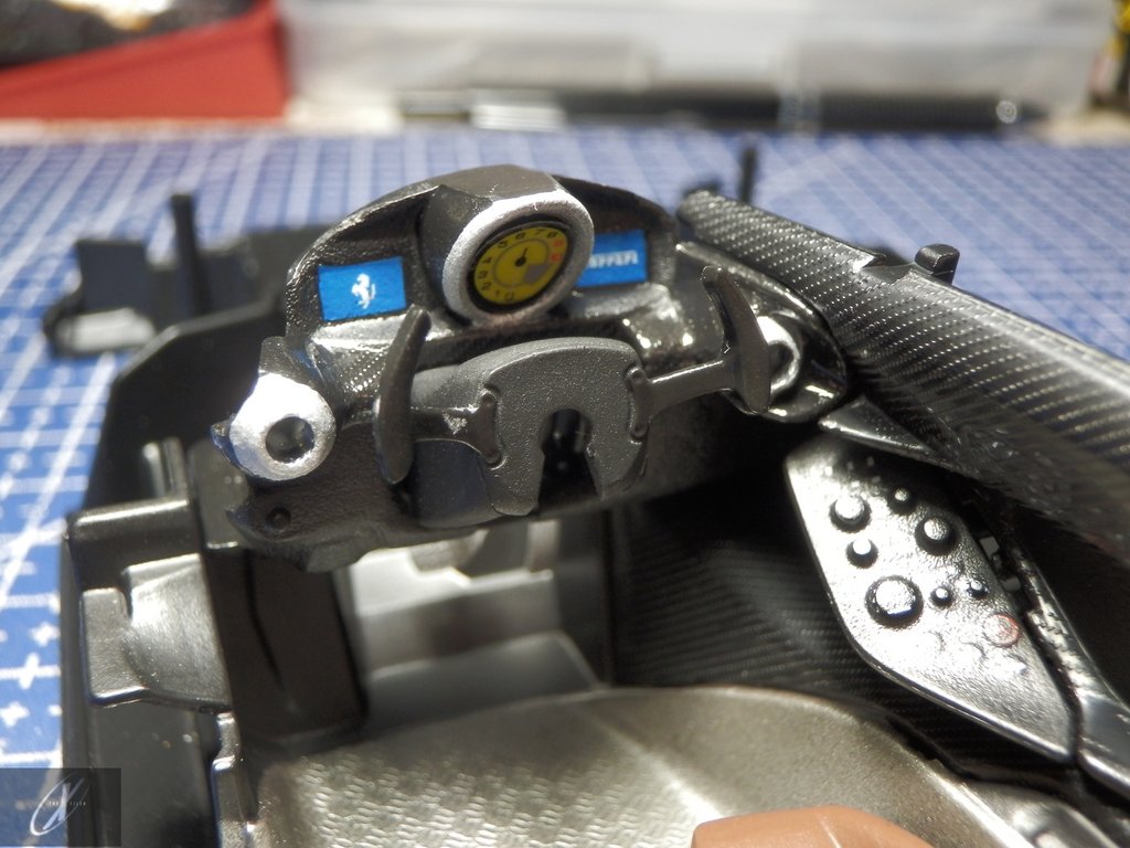

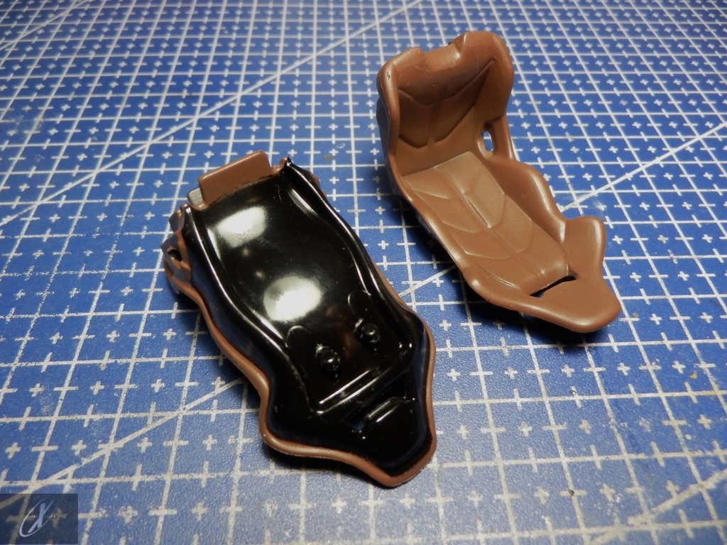

The all-black plastic cockpit:

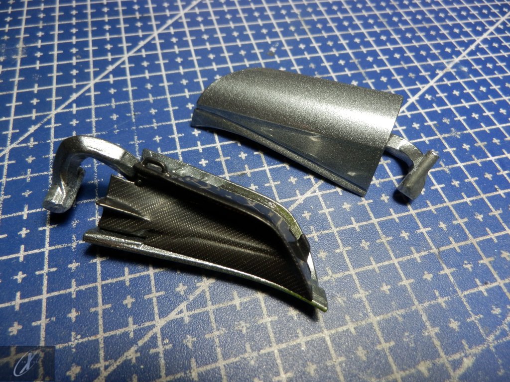

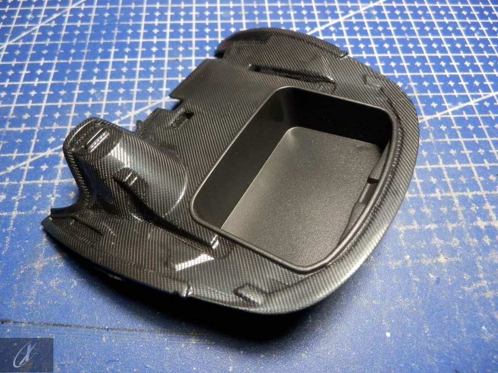

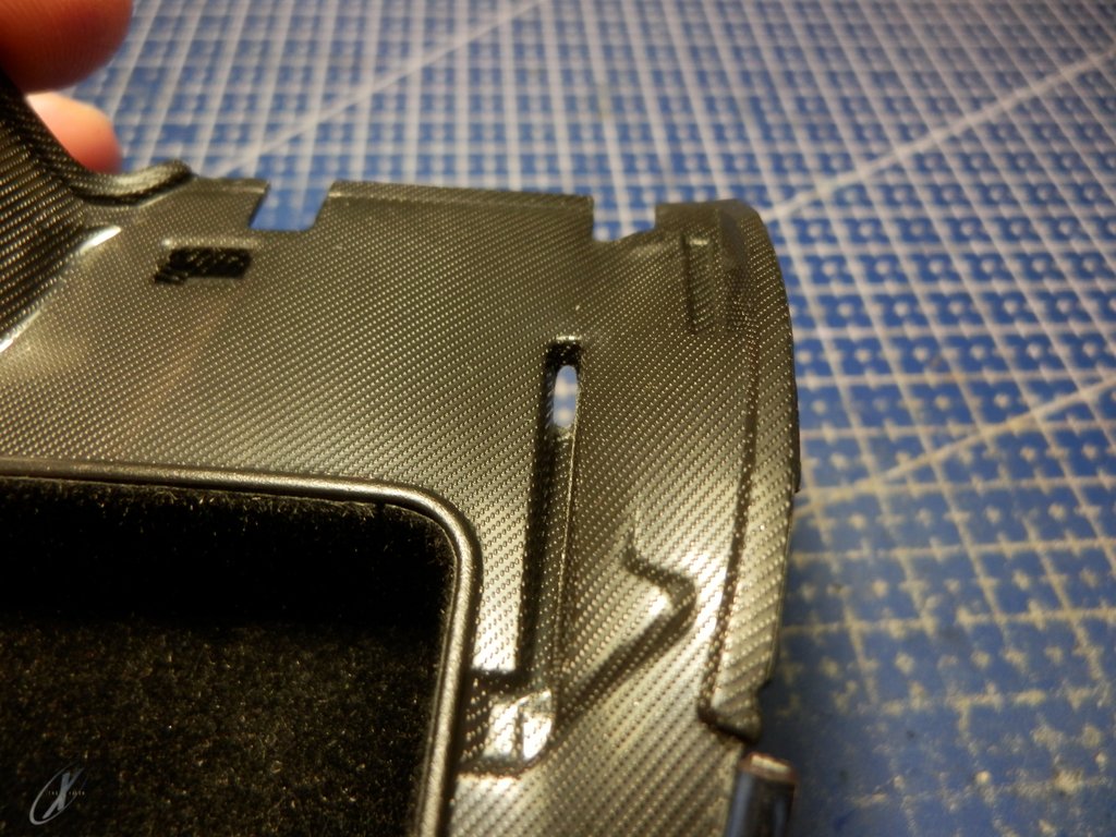

I'll remove the seatbelt fixation points and touch up the "carbon fibre" at the back:

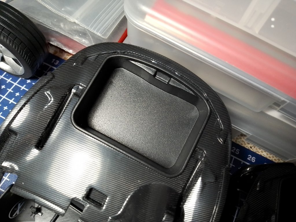

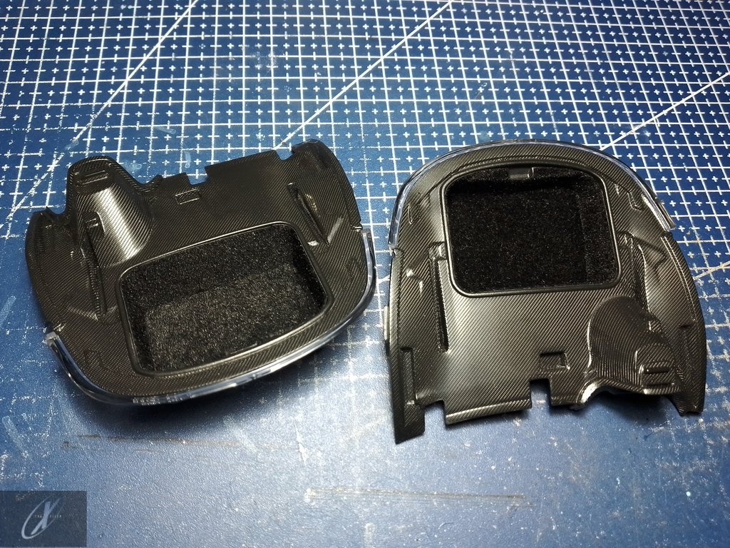

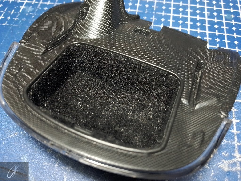

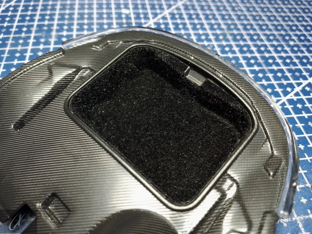

The car's luggage space is lined with an extremely thin carpet so I actually considered just spraying it with matt black but the owner of one of the cars prefered it was flocked throughout so... fluffy it is!

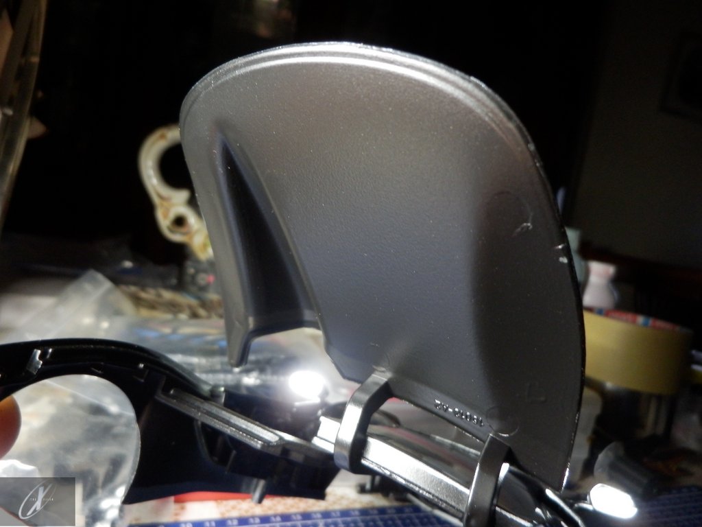

Door(s):

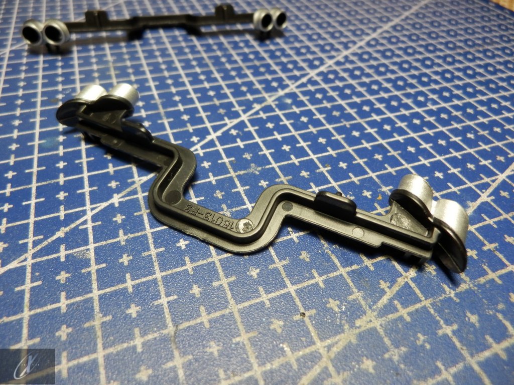

Even Ferrari uses fake exhaust tips...

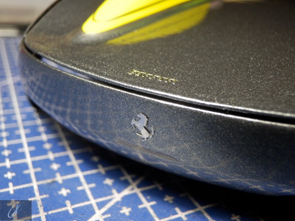

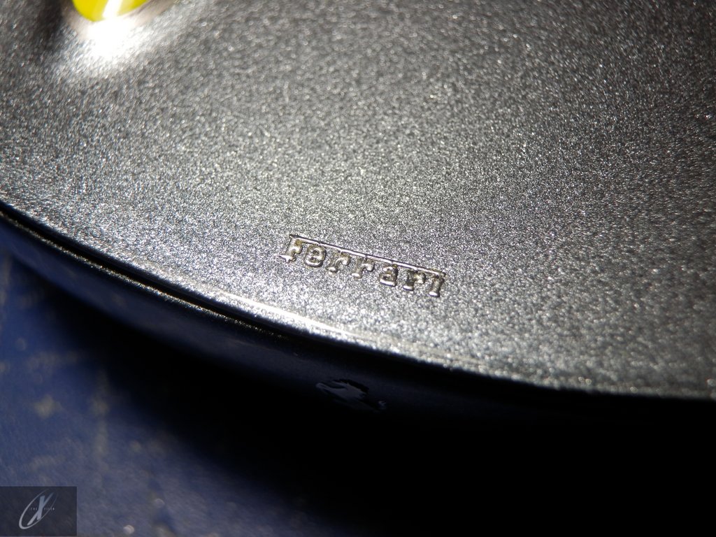

First thing I did after disassembly was to take out the ugly tampos with the Ferrari prancing horse and lettering:

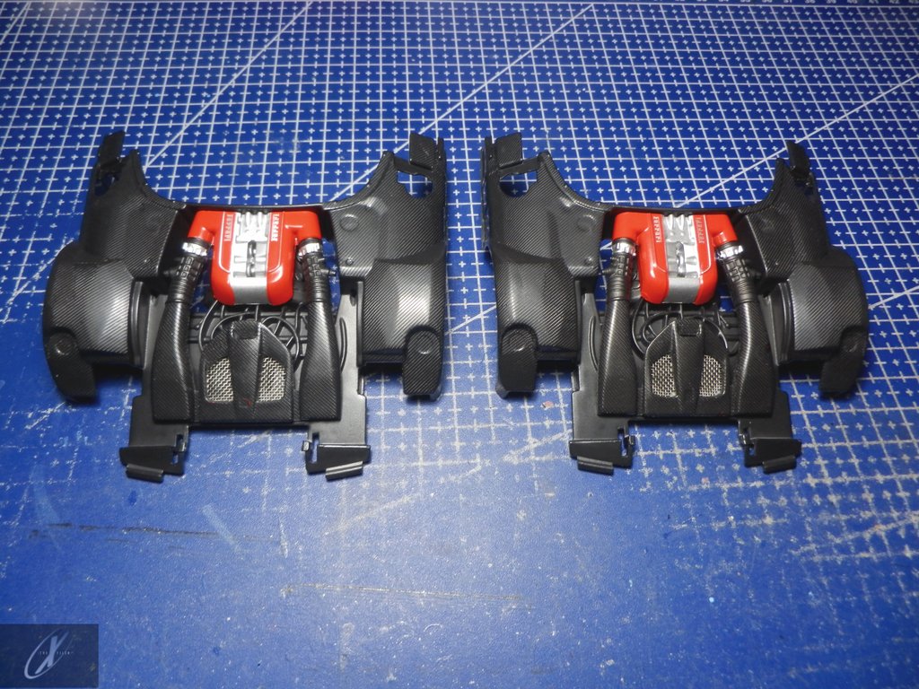

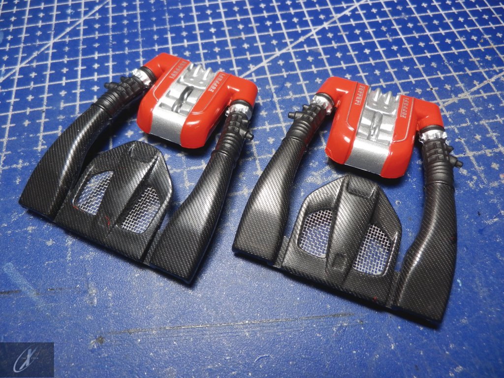

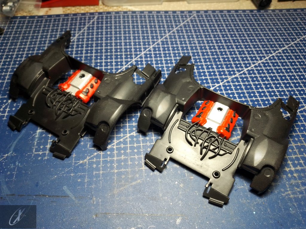

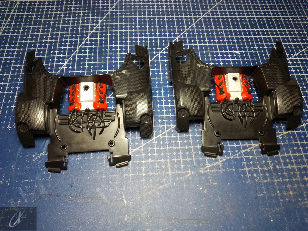

The engines:
Here I cut out the bottom of the moulding surrounding the valve covers, so that it gains a bit more depth:

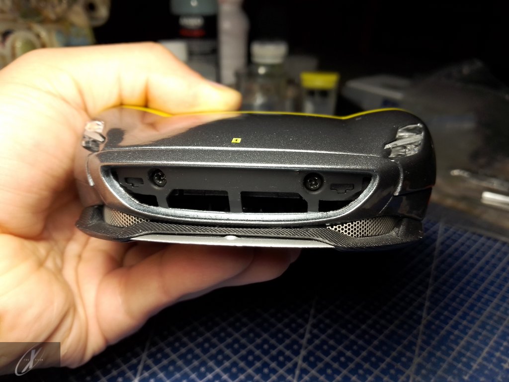

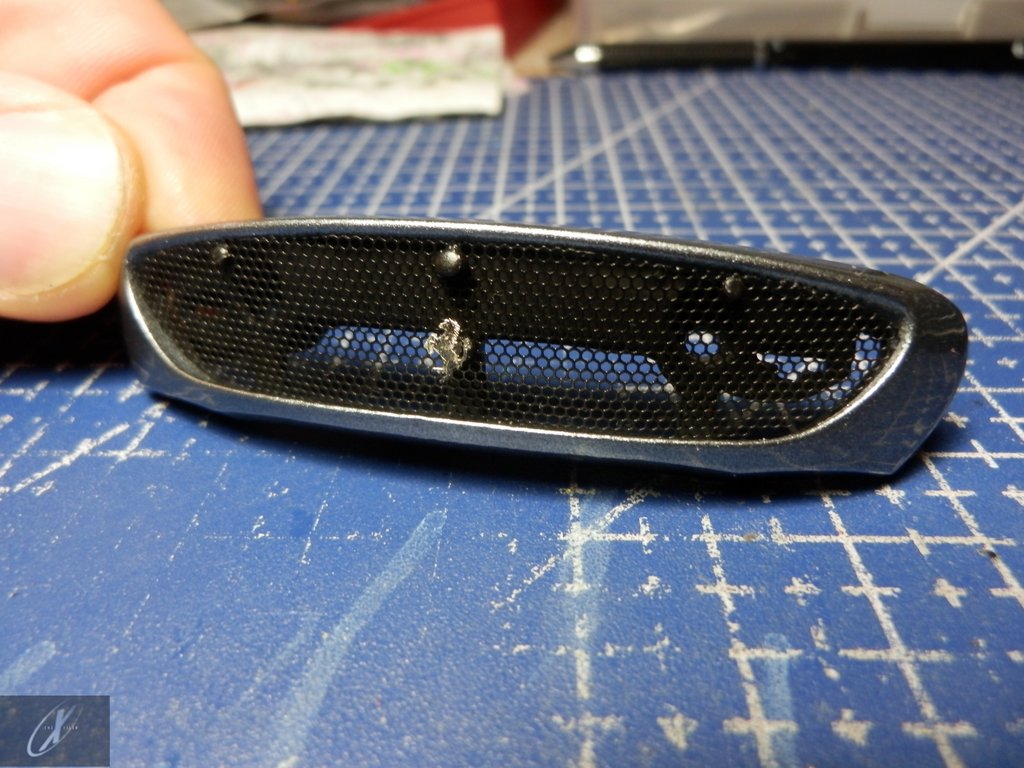

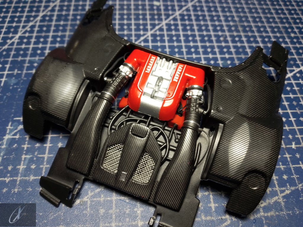

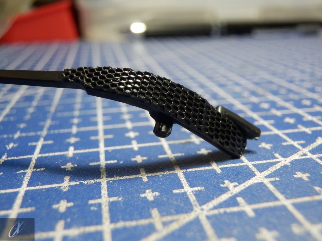

Here I carved the two air outlets which in the real car have meshes so... I added mesh too:

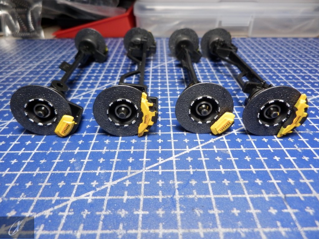

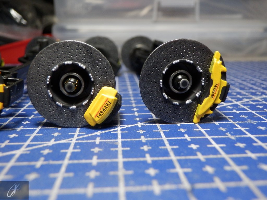

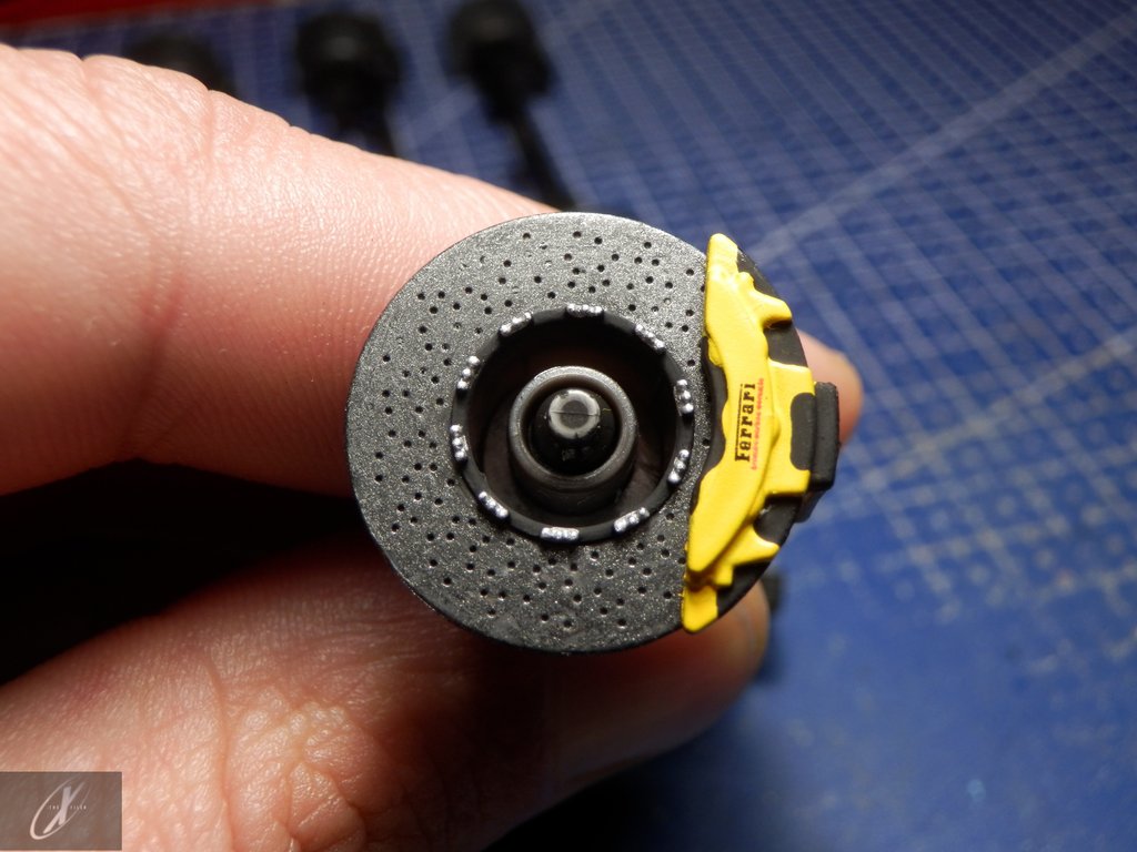

The brake discs are "carbonized" and added a bit of detail on the fixation plate and clamps. Also, blacked out the hollowed-out parts on the brake callipers, through which one should see the brake pads. The rear callipers are awful but I still haven't found a proper donor for those so, for the time being, I'll have to live with these:

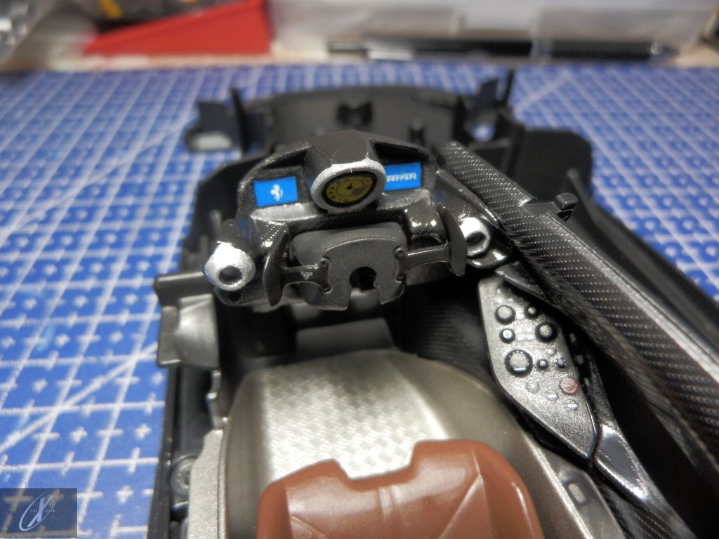

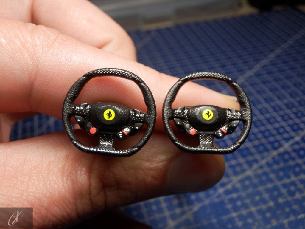

Added a couple of layers of clear coat, so that the carbon fibre patters stands out a bit on the steering wheels:

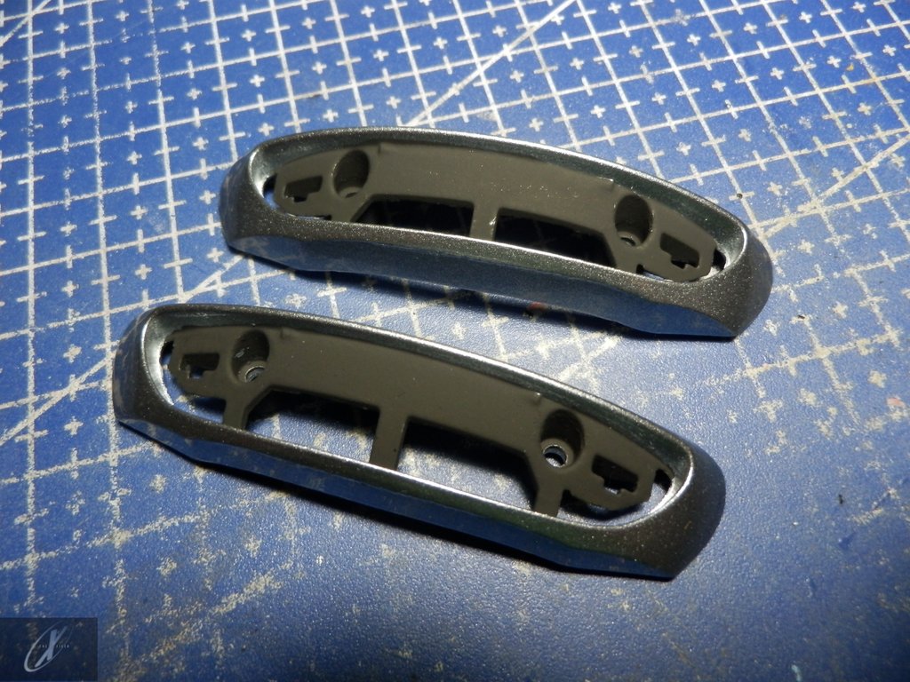

Painted the centre part of the air inlets, so that when I add the mesh it has a bit more depth::

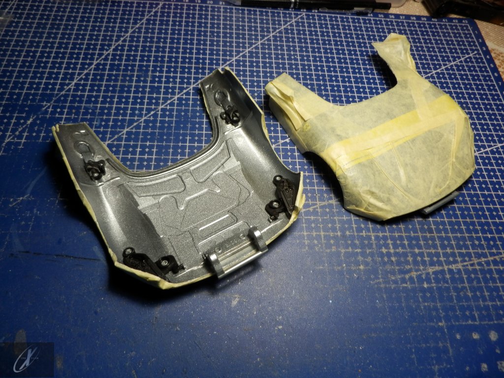

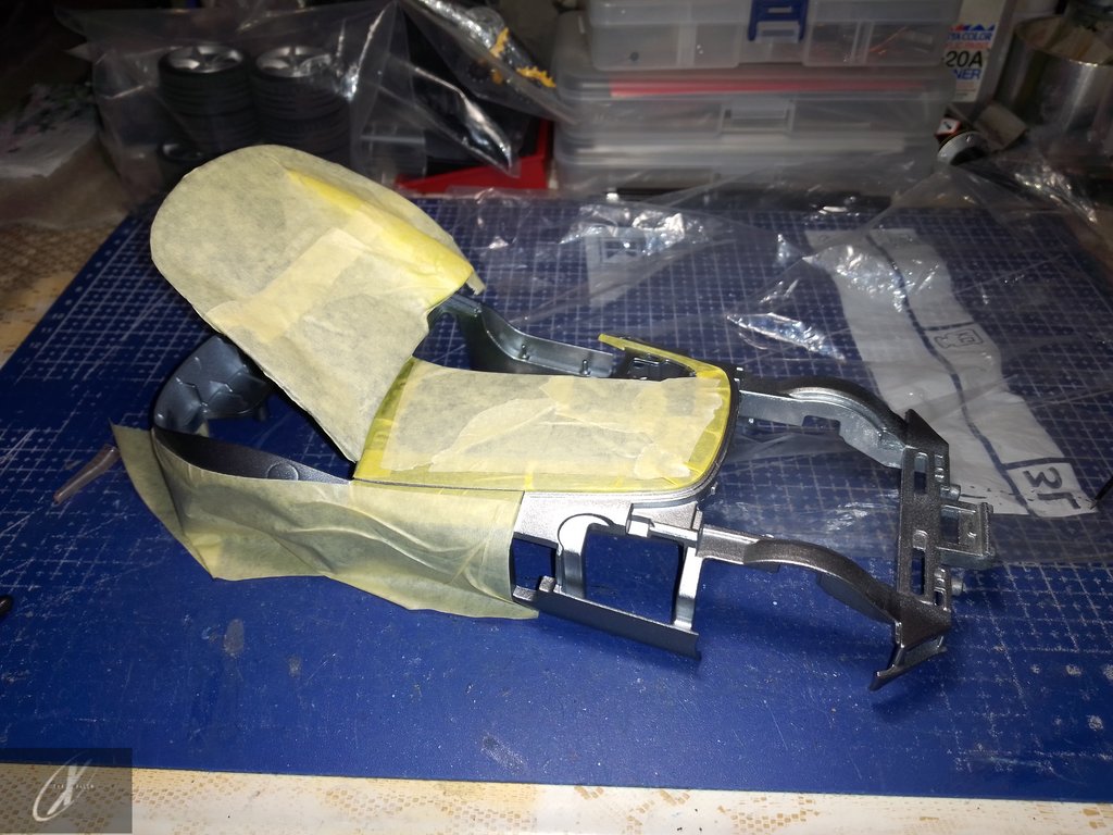

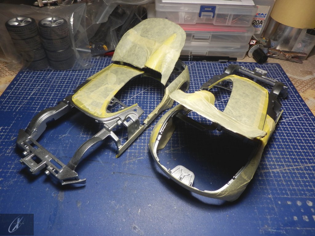

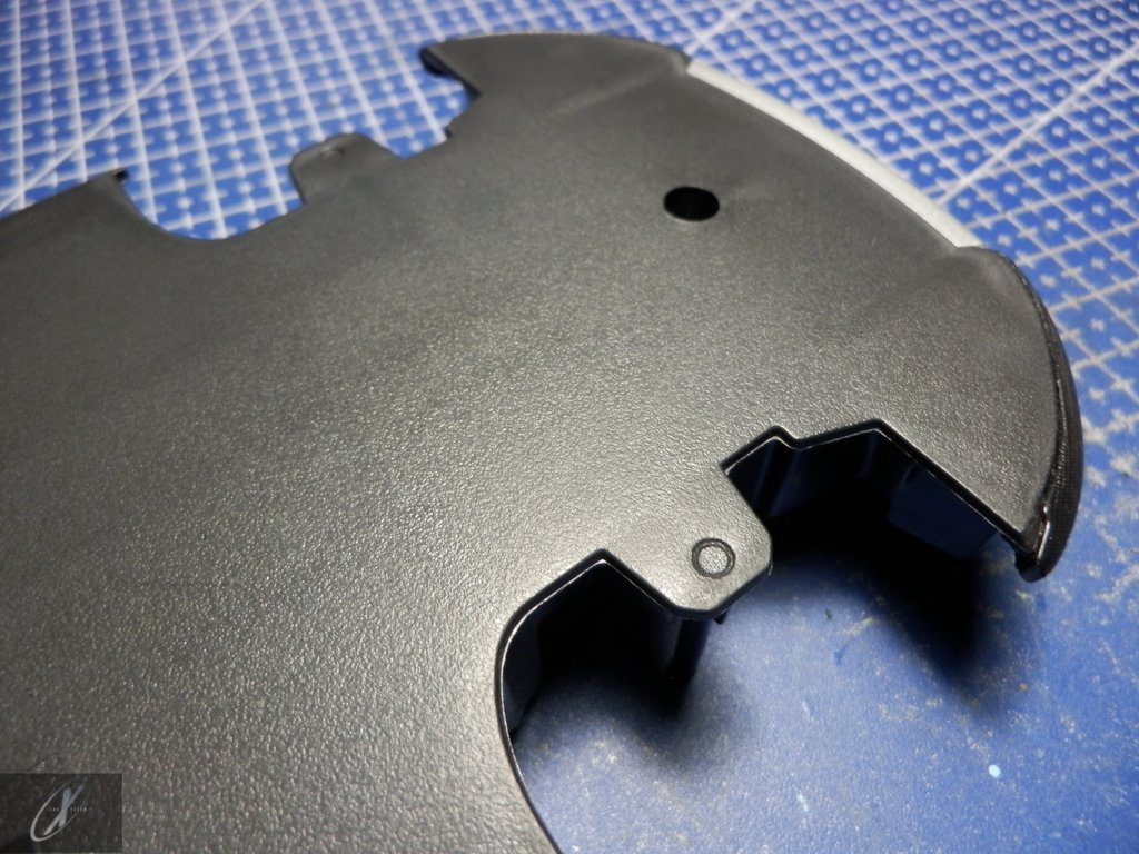

This is the part that bores me the most, masking the panels to paint them black on the inside. Took me 2 days (well, two evenings) to create these "mummies":
Sanded tyre thread (before and after):

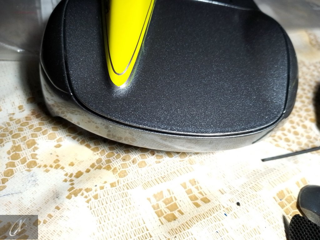

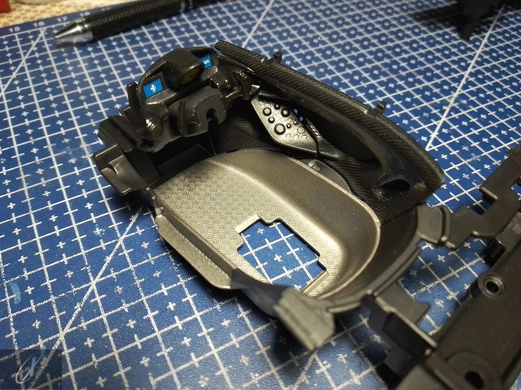

Added a bit of colour to the cockpit "cocoon". I had a "stainless steel" rattle can lying around, which had the perfect hue I was looking for:
Engine valve covers painted red (Ferrari 514). Now it's time to add all the sensor cables and spark plug leads:
