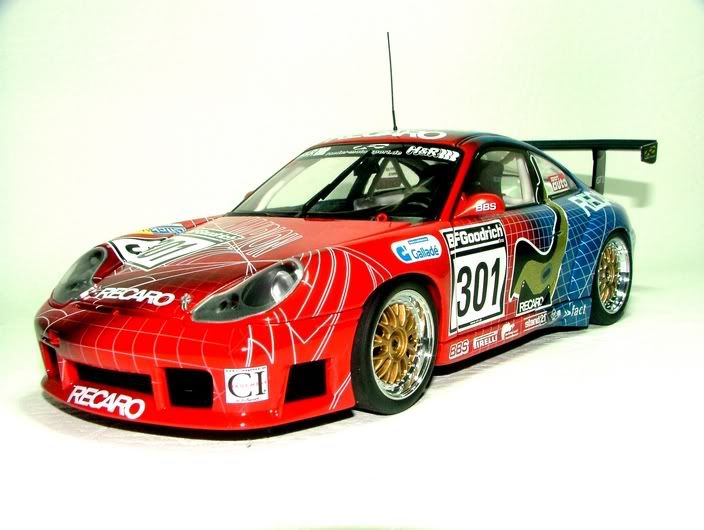

I had a quiet day today so I decided to try and come up with the best setup for my camera. Here are some of the results
Tell me what you like and dislike please! It will greatly help
The black and white one is my favourite!
Edit: my camera is a Fujifilm S 5000. Any suggestions would be very welcome.

The photos are very clear, great shots :nicejob :nicejob yes try natural light, or add another light source/lamp, you can play around with backgrounds as well, as sometimes I find darker backgrounds bring out the white/lighter colour models a lot more.
I do have to upgrade my camera, as I can't seem to get the whole car in focus.
Who wants it? I will gladly send it you :nana :tease
:lol
Natural lighting is a bit difficult in my place. I will try to take some photos on the roof, but the display case is two storeys down in the furthest part of the house! I may take one every now and then though. try to see the effect

Hey Bernard! Great looking car you got there :nicejob :nicejob You have a very good eye for picking angles to take pics of your car from too.

In the midst of all that tech talk, I complete forgot to say that I really like that black and white photo. B&W emphasizes contrast in texture and for that reason, the air vents in in the bodywork above the front tires look very nice! :nicejob :nicejob
